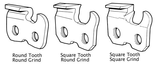

    ? Snip What tooth design is used for slabbing?
    Round tooth design mate but only on an 11° angle
  2. #542
    15,849
    7,305
    Interesting. On a saw blade a straight cut tooth (chisel tooth) is for ripping along the grain. The angle cut tooth is designed to slice the grain and cut. Effective cross cut. A straight chisel cut blade doesn't slice the grain in front of the cut.
    So the straight cut blade cuts faster on a chainsaw? What tooth design is used for slabbing?
    This is what is meant by square grind. Clearly cannot be achieved with a round file and takes far more skill, you take a triangle shaped file and go from outside the tooth in.
    Thanks winnie, that is not what I pictured in my head at all.
