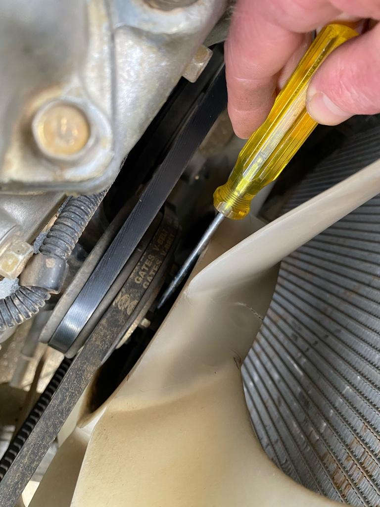

    So these four bolts here that iv got the screw driver pointing to?

    Yeah that will actually take the whole assembly off. If you can get a spanner on them then go your hardest.
    Take the top 2 off then hit your Ignition to turn your engine over half a cycle, Just tap your starter motor via ignition once or twice and it will slightly spin the engine., this will present the bottom 2 at the top.

    here is an image i grabbed off ebay.
    See the 4 holes in the fan are around the outside front of the Viscous assembly. if you can get your hand in and crack those you will make some space. If not then take out the 4 bolts out of the front of the water pump you are pointing at. This image shows you what it all looks like though.
