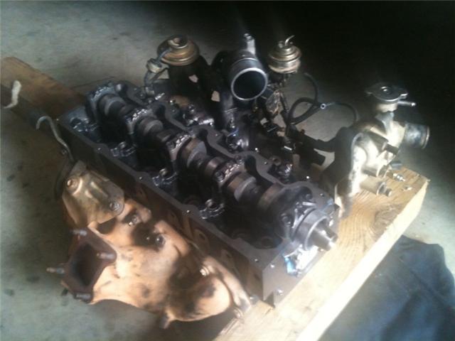

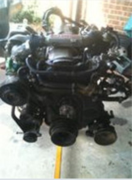

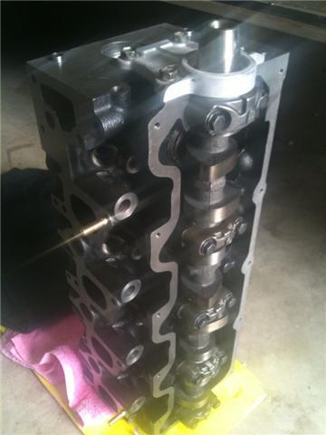

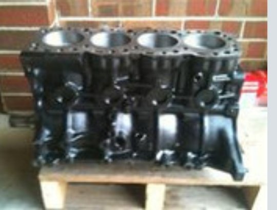

    Not that it's worth anything, but here's my 2 cents.
    My 4wd before I got the trol was a 2.4 TD Toyota surf. Go on have a laugh.
    These little engines are known for overheating, but the overall size makes these things nibble in the bush.
    I went through all the same shit, radiator, clutch fan, block flushed, gauges, at one stage replaced the head as it cracked. That was a $1385 job with me doing the labour. Was still have issues and about 6 months later had it booked in for a dyno. Came back with leaking combustion gases into the cooling system. A small hole or crack in the block. So I ended up with a reco short block. Not long are that I moved it on.
    It got to a point where I was driving with one eye on the road and the other on the temp gauge always. Couldn't tow anything, everytime it was under load the temp would climb.
    The last straw was driving through the Otways in the middle of winter it was probably 10 degrees outside and drizzling and I had to stop 3/4 the way up a hill because I was overheating.
    What I should've done from the start was drop a 1uz v8, 6 bolt mains and quad cams good for around 200kw.
    That's why I've got the gas blower, the 3lt stories scared the crap out of me and the 4.2 were out of $$$ range.
    I was done with diesels.
