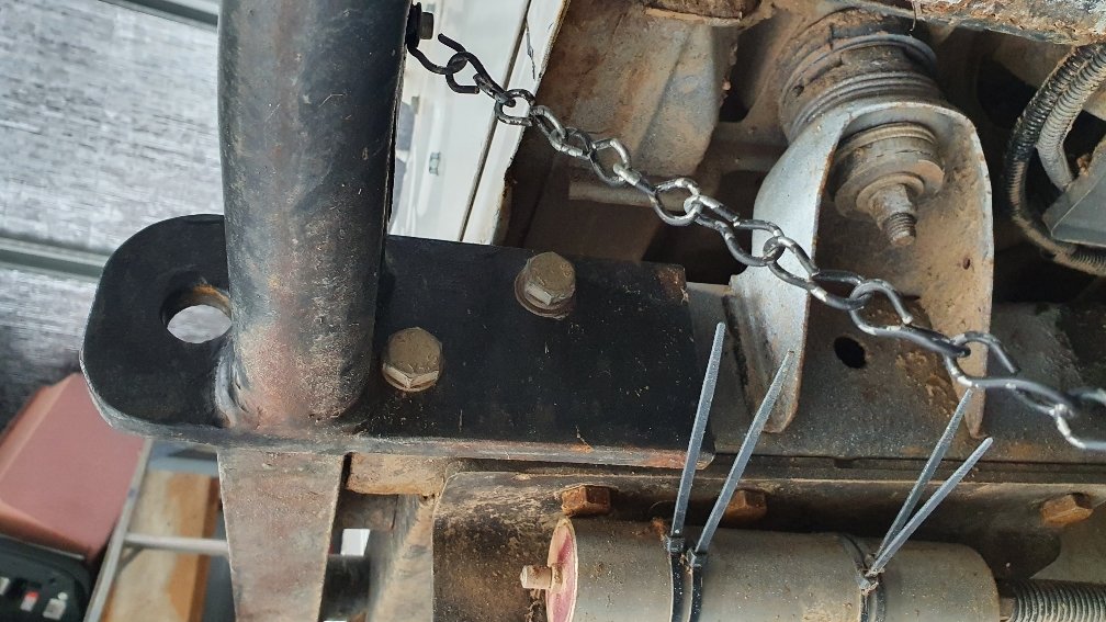

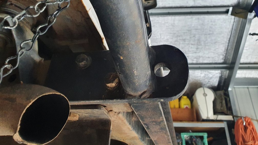

    I have decided I don't want to risk making a centre recovery point again so I have fitted the H&R tow at off the GUIV to the GQ.
    THIS IS NOT A DIRECT BOLT UP!
    The GQ tow bar bolts to the side of the chassis rail with 2 bolts. The GU tow bar bolts up under the chassis with 3 bolts..... I can make that work!!
    I used so angle I had to weld nuts to to use inside the chassis rails.
    First I drilled the holes in the angle and bolted it to the tow bar then welded the nuts in place.

    @MB here are a couple on the car mate. You could do similar but weld onto the top edge for sure mate 100% doable.
