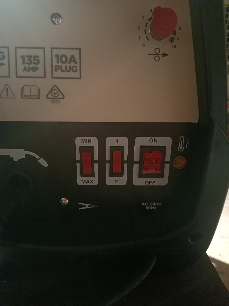

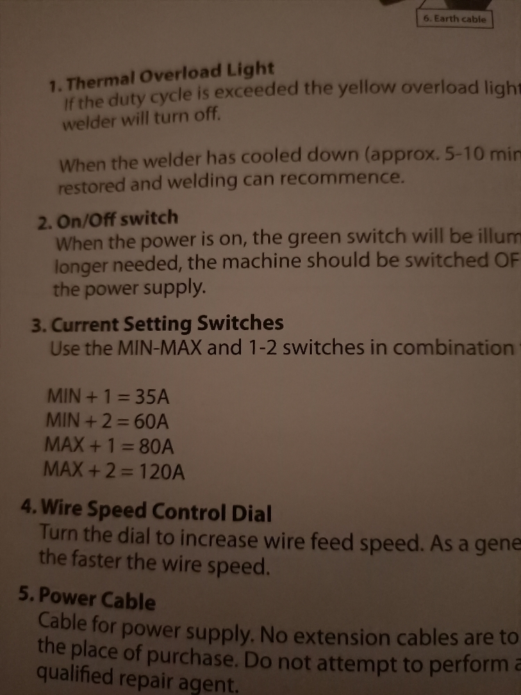

    Settings are 80 amp and 3 on the wire speed.Your right on the spatter Mark gas is cleaner. I'll grab some anti spatter from work next week and try that.
    I have a can of that but haven't used it yet.

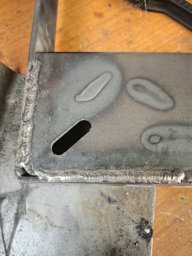

    Happy with this 4mm plate. Put the wire speed up a little to 4. Bugger all spatter.

    Thanks Jaysee, I will have a play around with mine however the controls are different to yours and no digital read-out - setting scale of 1 -10 and same for speed - hard to translate to mine but at least it shows on your 135 amp you are sitting at 80/135 and speed 3/? 10 maybe. Anyway its a heads up so thanks.

    Yeah, this is for the simple people, 2 switches and a wire feed.
    Simples
