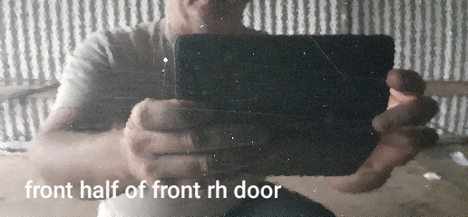

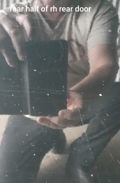

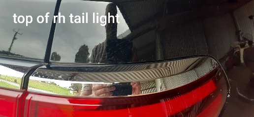

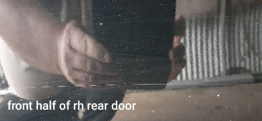

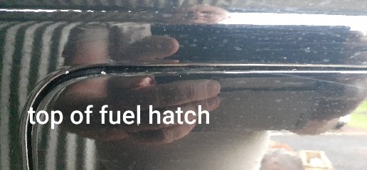

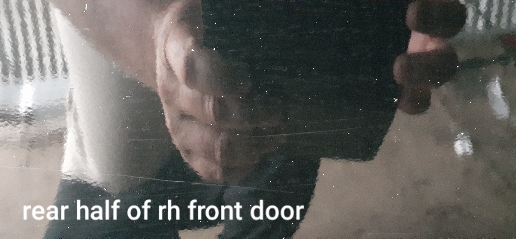

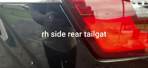

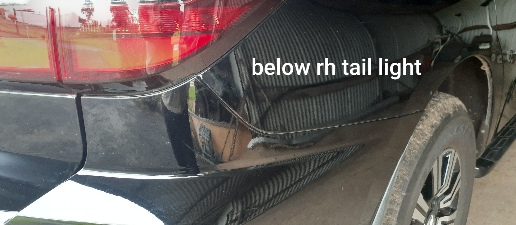

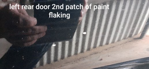

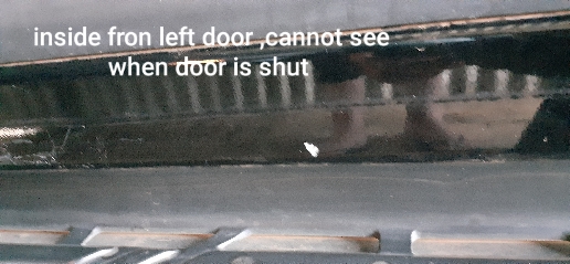

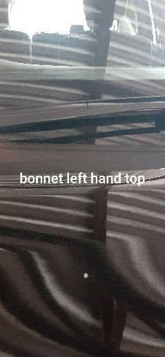

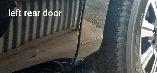

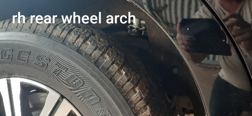

    As some may know one of the top 3 complaints to Nissan is the paint flaking off and taking big chunks of paimt with it,
    I am on a couple of Y62 pages and it is a probl3m.and see questions every day about it...i know
    My car had less than 10000km it's first service I mentioned it...the dealer had heard nothing
    I mentioned to them that on Y62 FB pages it has been discussed and told them that alot of dealerships do not know about it...so the service manager looked and up got back to me and said yes their is a bulliten and they have to follow certain steps in order to get it as warrenty...at this point I emailed pictures so I had a paper trail
    No problem, I asked if I could see the document but we the public are.not allowed but they assured me that yes Nissan Australia has released a bulletin....So the next service asked for them to check it out and sent them more photos,I include these here
    Then they had my car for the day as they have to measure,circle,count and take pictures a d get 2 quotes
    Now on these FB pages so many people say their dealerships are shit and tell them to go to panel beaters and get quotes then come back and say can't prove they aren't caused by stone chips....
    The dealer had to take photos of my car including accessories and they had to get pics of the original rims.tyres side steps the lot.....otherwise they have a case maybe who knows.
    here is pics if my 6month old car

    Yeah mate it looks like it is,inside and out,the painter told them.they can't do a close door as the chips inside doors,that another problem,not to many can do it as every panel needs to come off,glass out and all new plastics,bumpers front and rear and mirrors,apparently the front windows are expensive as shit because they have sensors
    My dealer sent me to Busselton 150km away as No shop in our town wanted it as it would take up to much room and time and they have insurance jobs....one guy has over 50 jobs on his books
    The dealerships here ha e been helpful,I am just waiting for one more quote and for Nissan to tick it off..they have done 3 in Busselton already

    Although the dealer said something about the clear coat used,it pulls tight on the paint and the slightest knock pull the paint off,I got shown tiny little bubbles in the clear coat that I didn't even notice
    Others say it's the eco paint
    Some say it was left to long between undercoat and first coat
    I wrote this up as Darren asked,hopefully it helps,

    Got the ok today for a respray
    So car was serviced 18/07/20
    Mentioned defected paint
    They took pics measured circled do what they do
    Got 1 quote local so we had to take it to another dealer and they got another
    06/08/20 Got a phone call it has been approved,and a hire car while it is off the road...
