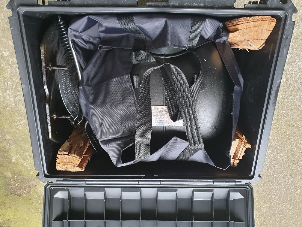

    Good comment about the box that always gives.
    Have a look at how well an ozpig fits inside.

    That is a handy fit, for sure.
    Good one.

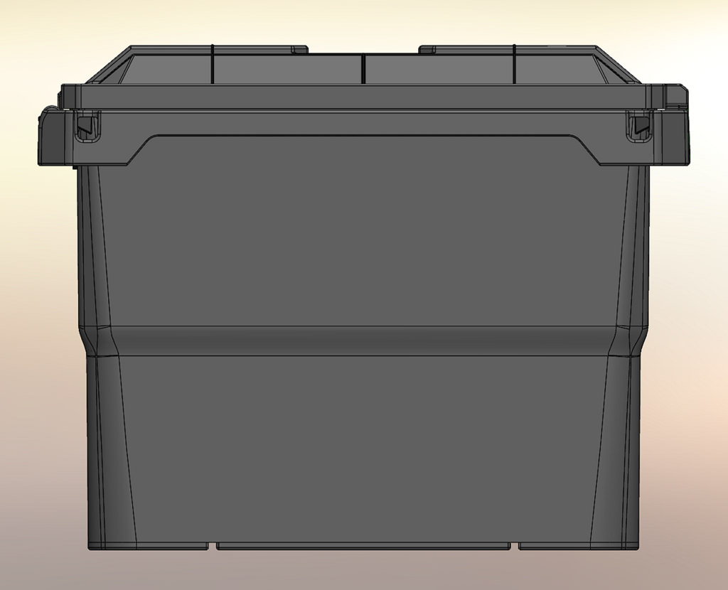

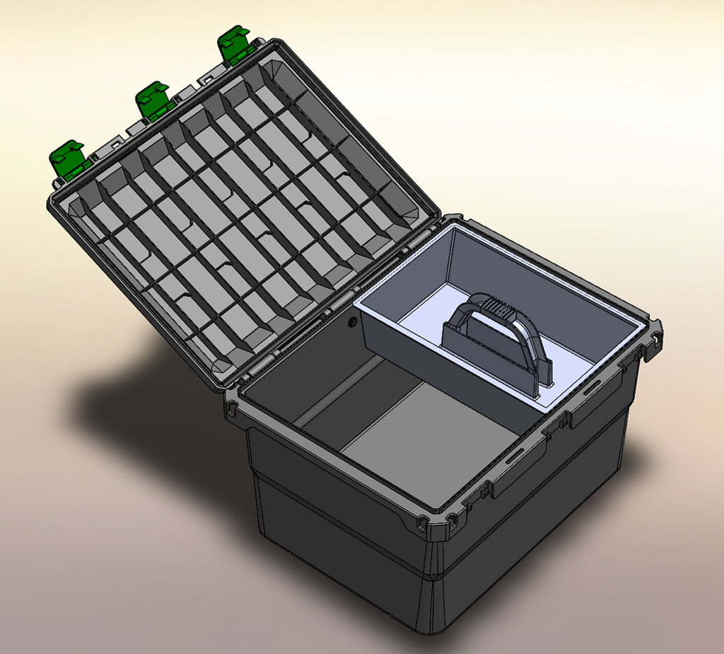

    We've finalised the design of the first box at 55 litres (578mmx440mmx342mm). We've got a plan to design a series of box sizes now that compete with the Space Cases and Tuff boxes etc. but that actually seal properly, have no metal parts, are designed for the 4wd, camping and quad bike market primarily, but also the marine industry etc. We also want to price these realistically and think we can do this.
    Its been a steep learning curve for sure and we have had some fantastic support from the likes of Brad McCarthy from MaxTrax and Michael McMillan from Australian Expedition Vehicles amongst others. Yes, it does have tapered sides and an outside lip but this is necessary for Injection Moulding to work properly. Tapering the sides was a big decision to make, but a vertical sided box with the lip on the outside would also 'waste' that space in between boxes. It's all a compromise. Tapering brought significant cost savings too. Mostly in freight because the boxes will 'nest' when stacked in towers on a pallet or when empty and stacked in the side of the shed at home. We did however keep the taper absolutely minimised and put a step in it for strength and to keep the sides as vertical as possible but still smooth for easy wiping out.
    The lids come off and will also stack nicely on top of each other. The box is also lockable with three different size padlocks in two places.
    PastedGraphic-16 by Ben Kincade,
    PastedGraphic-15 by Ben Kincade,
    PastedGraphic-18 by Ben Kincade,

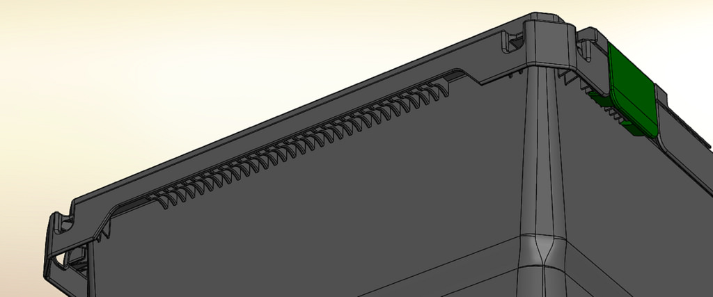

    The grip area on the ends of the box has been loaded with ribs to prevent fingers jamming and also to add strength to the lip.
    You can also see the tie-down points on each corner. These are for turn-buckles or ropes. They are 12mm wide, reinforced and rounded off so ropes won't wear on square edges. Using these points means you can access the box contents without having to undo ratchet straps, another reason for the lip on the outside.
    The lid profile also retains ratchet straps in place in the grooves, as well as facilitates stacking of other boxes so they won't move around.
    If anyone has any further suggestions I am all ears. We are getting really keen to bust out a prototype and test it all.
    I'd love to see a box made into a fishing box. It should last forever. Saw the lift out tray and immediately thought of a fishing box.
    In WA it's law to wear life jackets in some areas whilst rock fishing and I believe voluntary to tie off to tie down points, which I do.
    One of your boxes is dedicated to a life jacket, rated rope, and other stuff.
    If you can design a fishing box, I'd buy one, for sure.
    I love the 8 that I purchased during your initial order. Bargin!
    Well done, keep up the fantastic work, and "Thank you"

    We are thinking about another size now too. Have had a fair few calls requesting both larger and smaller versions. Trays that fit inside was another one.
    @DX grunt - there are some lure boxes that fit nicely in the boxes standing up on their sides. Can't remember now who was doing that with them, but they managed to fit about five or six across.

    Cheers guys. Playing with designs so that a slim line would still lock onto the lids of the larger boxes in the same way they do now. Same lid features and tie down points and same flat smooth interior. It will probably come in around 32 litres instead of 55 litres.
    Still thinking through it.
