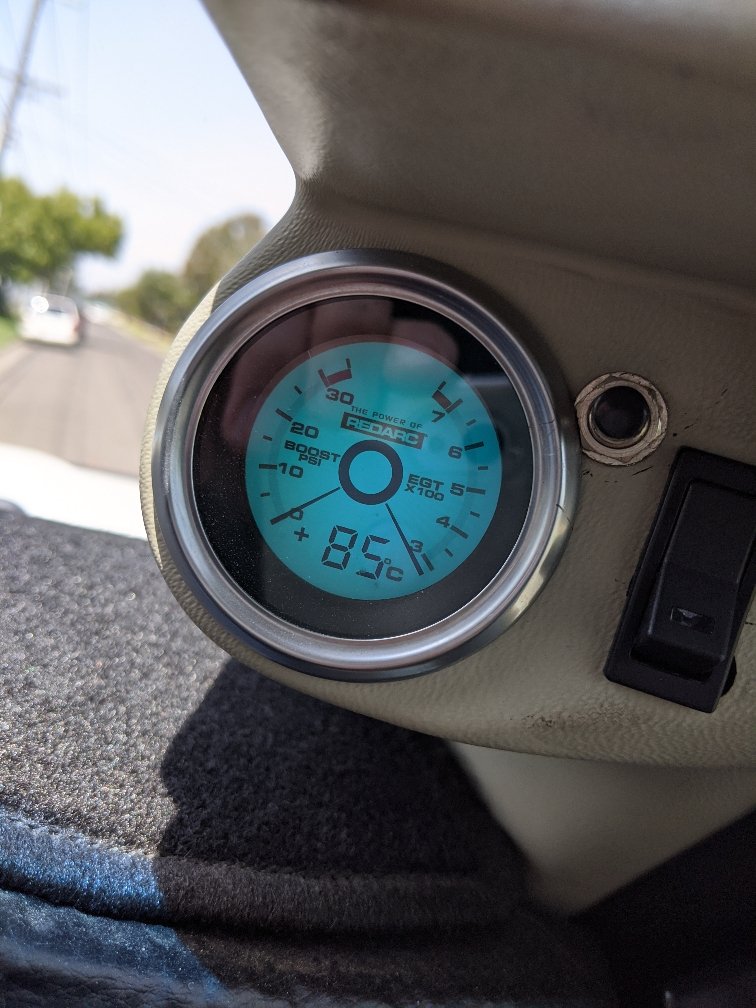

    Usually With my car I'd have to be pushing it to get over 85 ,normal driving conditions.
    Today simply idling with AC on, it began climbing from its usual resting place of 78... And then it sat going between 85-87 ... Never ever seen it do that before .
  7. The Following User Says Thank You to Hodge For This Useful Post:
    Stress Less Hodgey Mate!
    Running Mrs MB’s deep winter to peak summer stability now of 88C<>98C comfortably efficient and most happy it appears.
    A kind Guru suggested on here somewhere their “Sweet Spot” was around 92C and I now 100% agree from personal findings
    Tough donk they are and will go a lot higher with short term consciousness
    No worries here at all Marko mate. Mind you it was sitting in sun with circa 43C ambient ... Reliably kept me cool!
