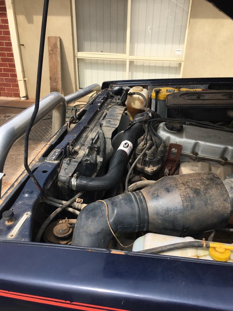

    Engine fan is in, new radiator hoses is in along with radiator, bled the cooling system.
    Choke knob is in.

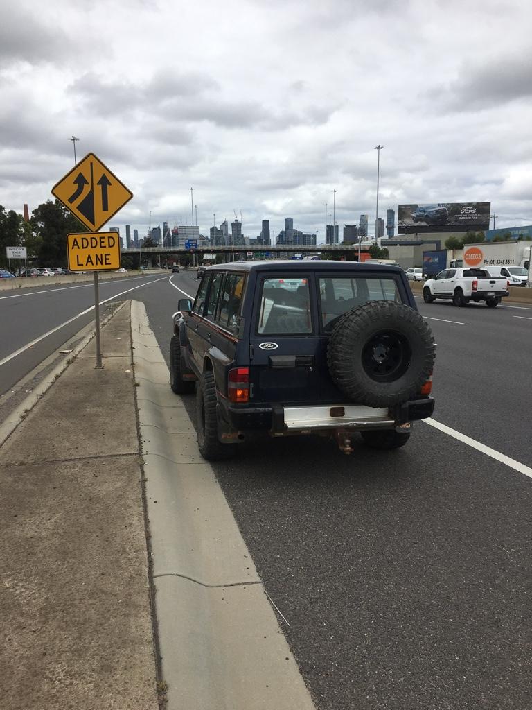

    I thought I’d drive the Mav (unreg permit of course) from my mates in Hoppers to my place and that happened.
    I don’t have clutch lol
    It drove fine and on the freeway, it started to slip there and there, until I went over Westgate when I went downhill, it didn’t want to be a clutch.
    Now, I’m waiting for tow truck to come.
