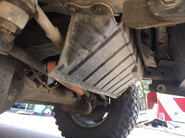

    Somewhat irrelevant to thermostats folks, big believer in stock designed positive/negative air pressure zones now.
    Many a great sand driver folks hate these ‘Air Dams’ as they ‘rip off’ when reversing have read but do believe down here they are integral for our highway needs.
    EDIT: Mrs MB’s near stocky dam :-)
    I put that back on mine, did absolutely nothing to help the kettle from boiling.

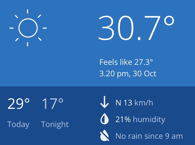

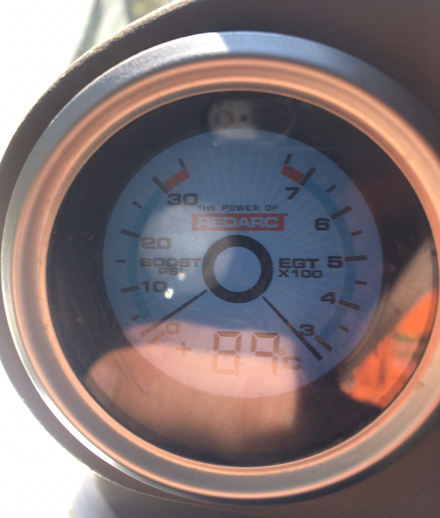

    Success....finally managed to just get the 88C thermostat to fully open up on our steppest test hill home bound.
    Our ambient temps have finally snuck a whisker over 30C and deliberately ran this test with A/C on flat out today.
    Coasting back down the other side she’s straight back to 89C so pretty happy with that.
    Bring on the hotter weather now as last summers max coolant temp was 98C too IIRC with the old 76.5C thermostat.
    Here’s hoping that the factory blocked Jiggle Pins on these 82&88C thermostats although fantastic in winter hopefully don’t hinder over summer.

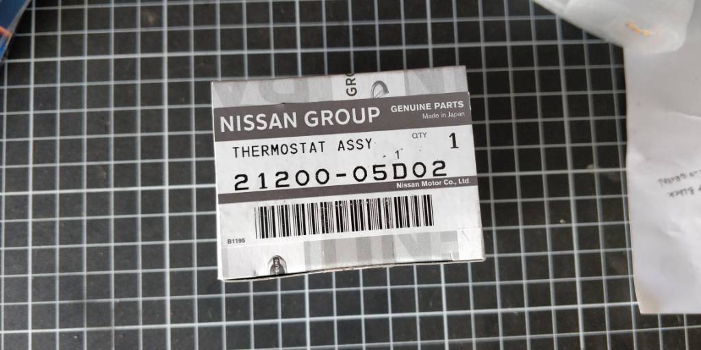

    Funny you should mention someone else trialling a 82° thermostat @MB, I just picked one up from Nissan on Wednesday
    I was thinking of fitting it as we move out of summer though.

    Don’t be a pussy, stick it in now for comparison clarity Cremulator mate
