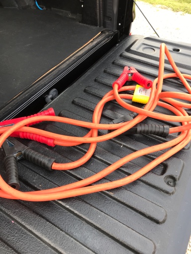

    I have these
    https://automotivesuperstore.com.au/projecta-nb750-60sp

    Holy crap YB, you must do a lot of jump starting?????
    No
    I acquired them through work

    Ok looks like I led you up the garden path
    They looked similar. Oops
    My leads are Matson brand 50mm sq
    Still heavy enough to start most things
