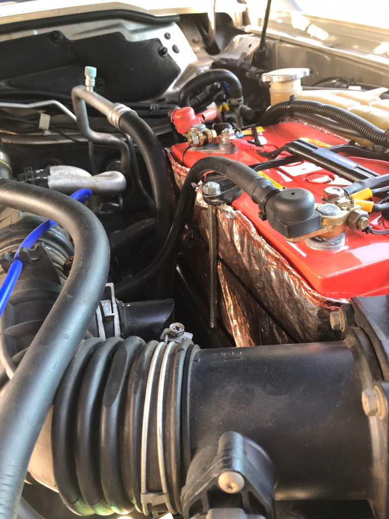

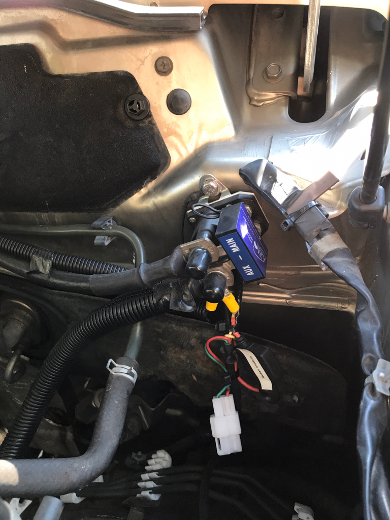

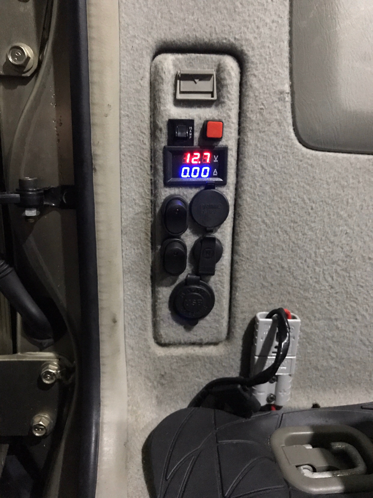

    Most battery trays can only take a battery that’s 305 mm long which will limit you to 105-110 ah
    Anything over that capacity goes up to the next size case that’s 330mm long and also taller.
    My old Patrol had a VSR connecting my batteries with leads strong enough to start off either battery and had a link switch on the dash.
    My second battery was a 110 ah Ultimate Extreme AGM and would run my 60 litre Waeco for 4 days easy.
    I had an Anderson plug on the tow bar connected to the AgM battery so I could hook a solar panel up and if needed although it never was, I could link the batteries and charge both.
    It was a basic set up that worked
