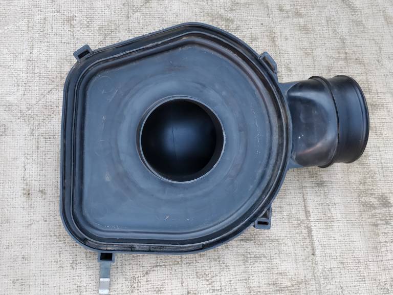

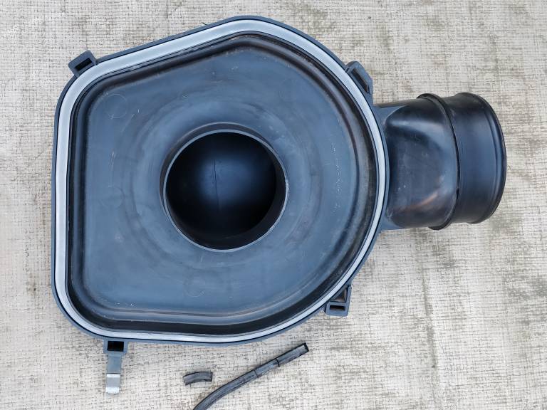

    Replaced the seal in my air box. There was only a small piece of the old seal left in the lid and a few shall pieces in the air box. Very hard and brittle.

    Yeh I had no idea about this potential issue either. I just opened up the air box to inspect the filter and give it a clean and saw some large black fragments in there. Turned over the lid and found where they had come from. Basically the original seal feels like charcoal it was so old.
    This is the one I bought from eBay – $21.90 + free postage.
    NISSAN PATROL GU AIRBOX SEAL97to17 Diesels Engineered to Fit! ONE PIECE MOULDED! https://www.ebay.com.au/itm/NISSAN-P...-/123644772852

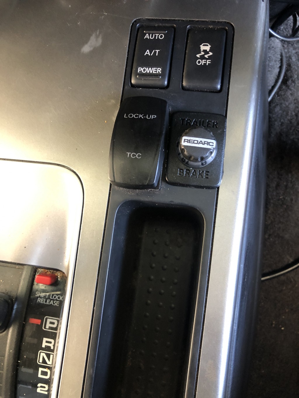

    Finally got around to installing my Redarc towpro elite and a couple of Anderson’s on the rear bumper for trailer power and solar input. I knew there was a reason I’ve been putting it off, running cables shits me!
