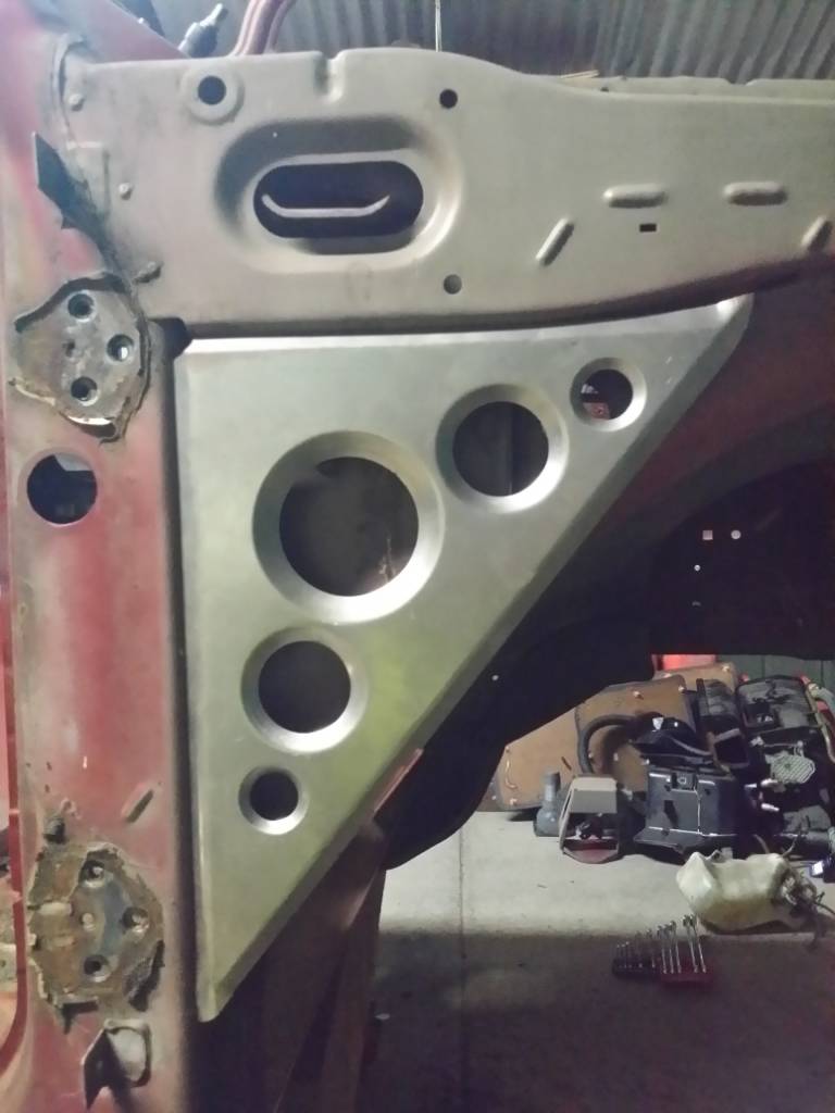

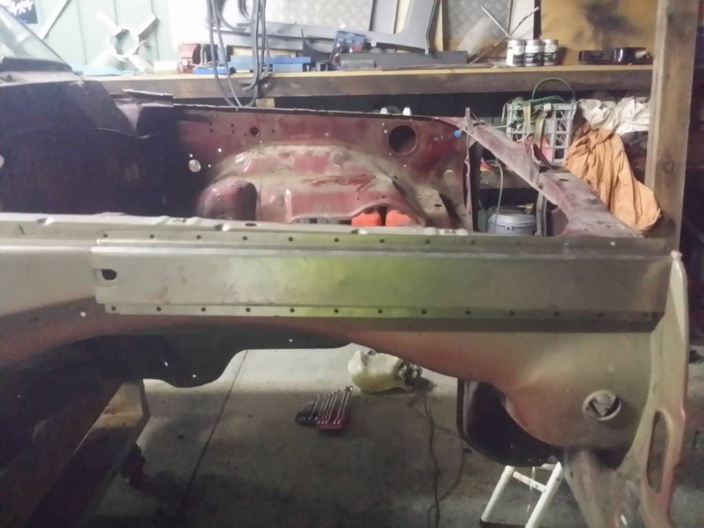

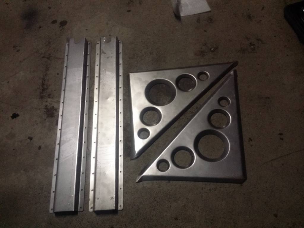

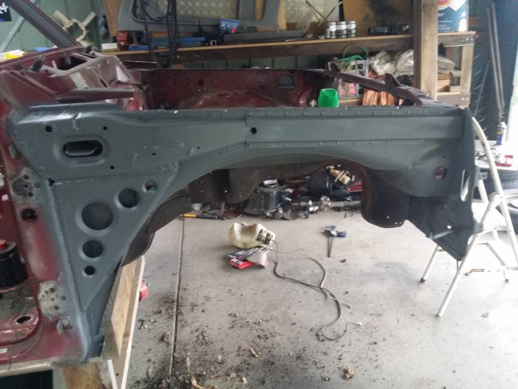

    Hey mate, when I put a new shell on my GQ put in a bracing kit from Big O 4x4 in SA. Old cab had lots of rust but also front inner guards were cracked both under the battery and near where the front clip joins the cab so kit was no brainer while apart. Guess panel beater would be a go to to repair unless your handy with a welder.
