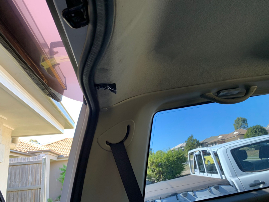

    Seems like info is hard to come by for options to have child restraint points installed in a GU while having drawers installed similar to the Kings ones.
    After much trawling online there were rumours of being able to install restraint points in the roof but not much info online so thought I’d chuck up a post.
    You need to pop off the roof lining (no need to remove completely, just slide it to the front of the car) to show the rear support beams near the barn doors.

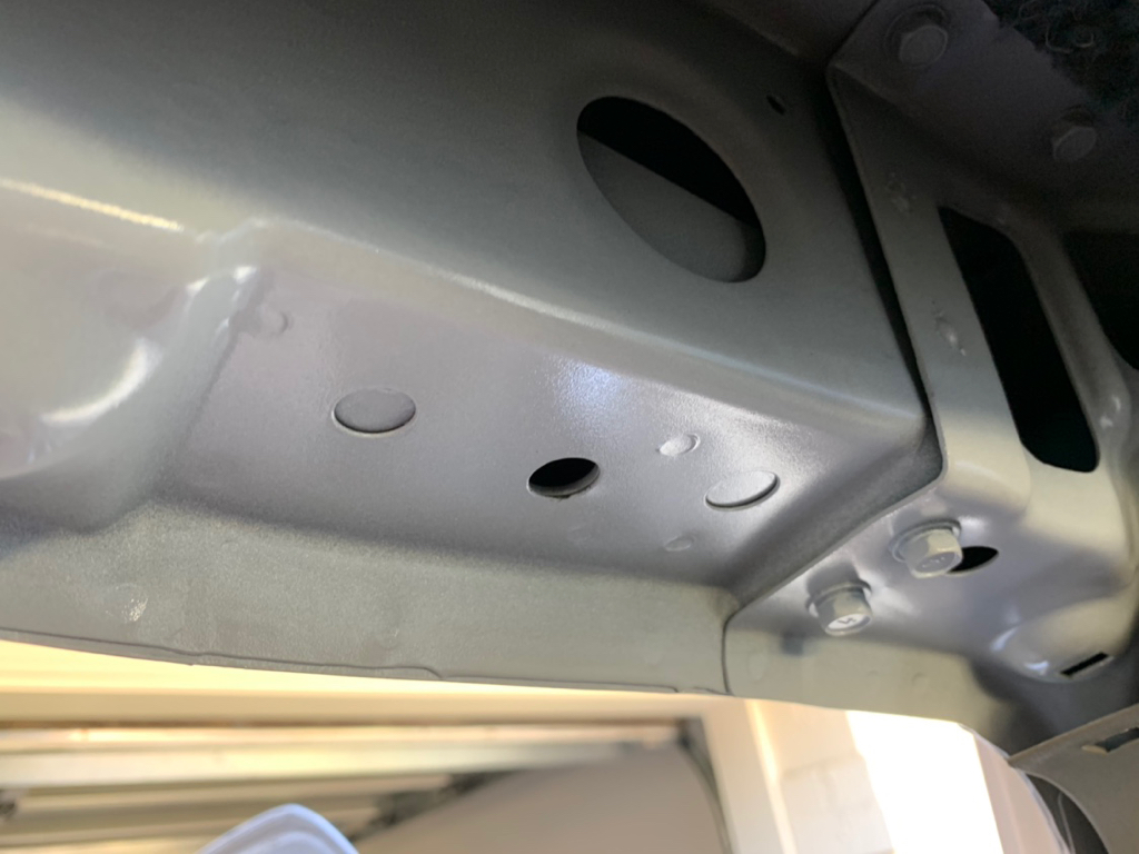

    Closer look at the specific location used. It is double plated so plenty of strength.

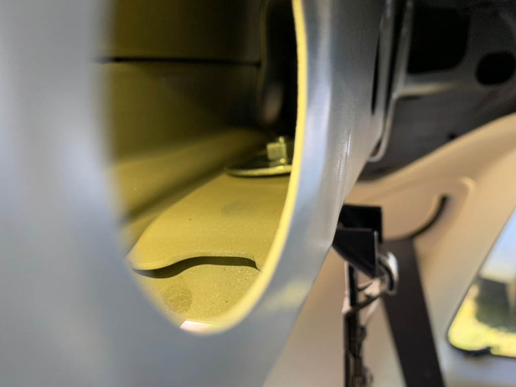

    You will need a magnetic pick up tool to make your life easy here. Place the dimpled washer from the large hole in the right of the pic in the above post. It should locate itself easily enough over the hole.
    Then use the magnetic tool again to place the nut and spring washer. A small screw driver is your friend to keep them in place while you detach them from the magnet.
    Start the bolt threading on by hand slowly till you can feel it grip the threads. Then get a spanner onto the nut through the same opening. Little tip to stuff a rag over the column that holds the tail light in case the spanner slips out of your hand.

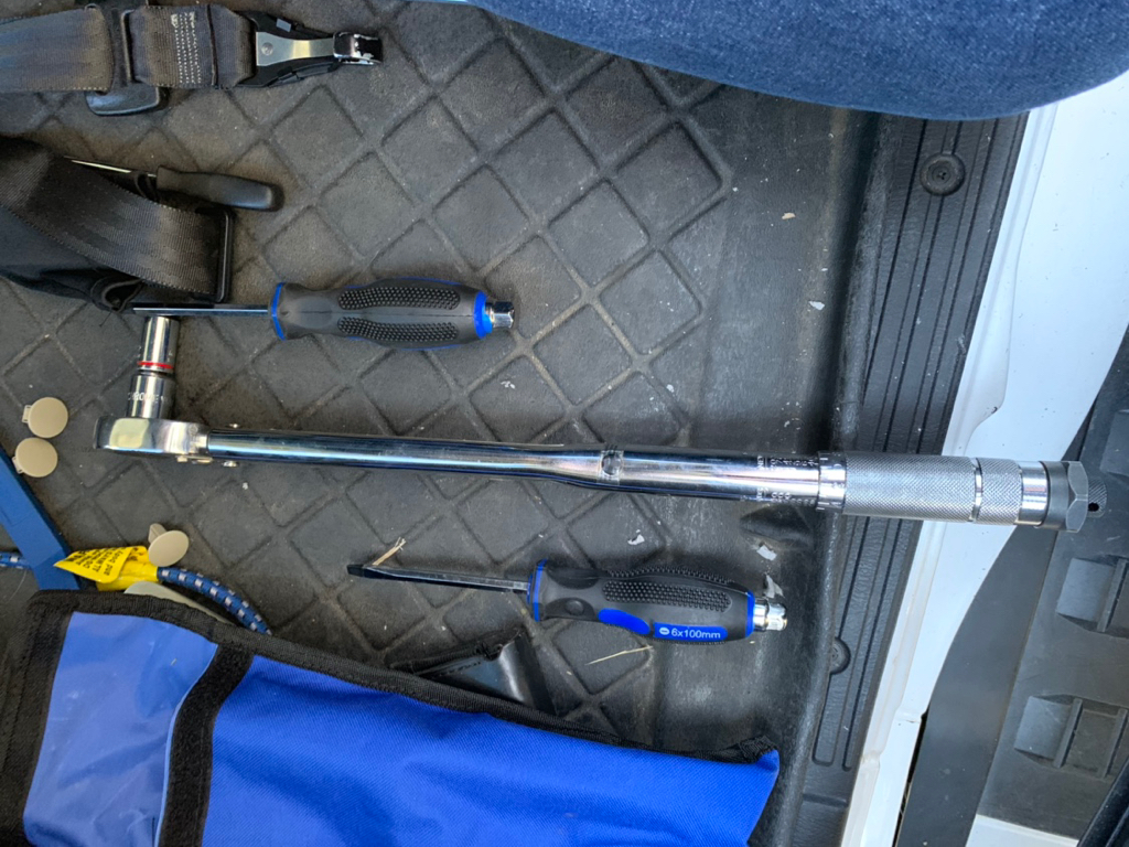

    Torque her up while ensuring to keep the restraint point straight. I just keep it slightly off centre and then tighten the point clockwise once torqued to ensure I didn’t loosen it.
