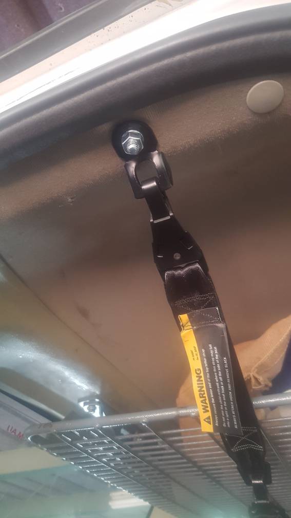

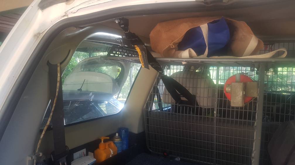

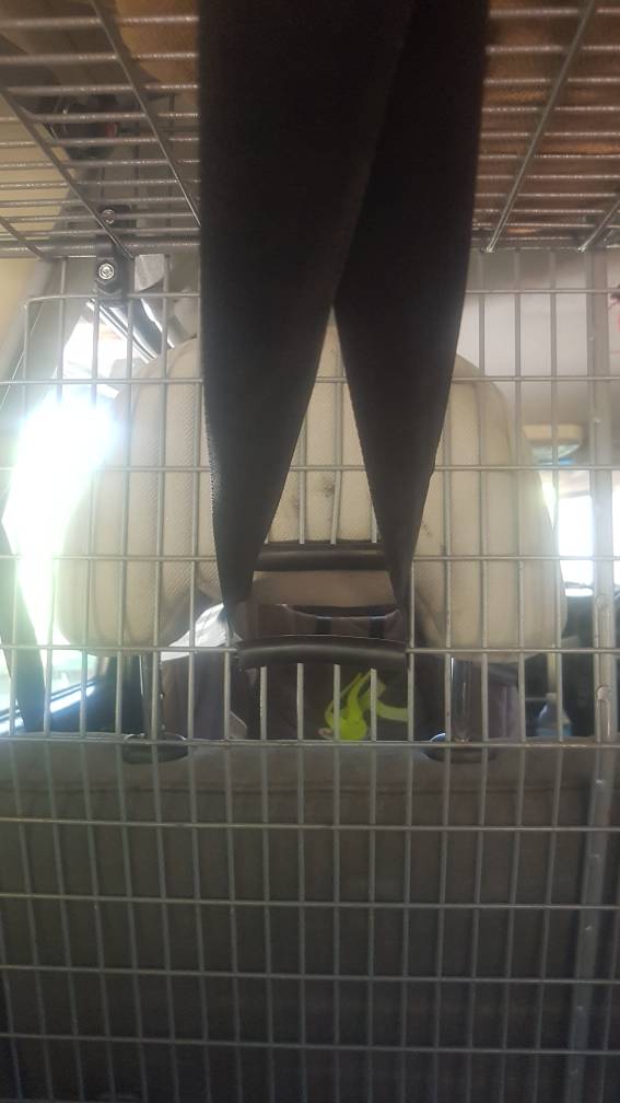

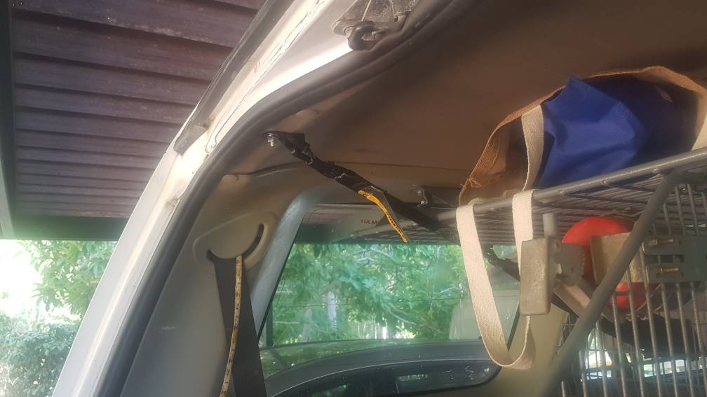

    Hey mate, got a quote from a child restraint fitting company, and while doing so told me he would need to install the point in my roof but did not say where. I did some digging on the web and someone else over at p4x4 had the same issue and paid the bloke to do it. I pulled back my roof panel after buying the bits needed today to have a look to see how accessible etc and if I could do myself. Turns out Nissan already have a hole drilled through the rear support strut that is also already reinforced. With some difficulty I managed to get the bolt located with washer and it's not all fitted up. See photos for reference.
