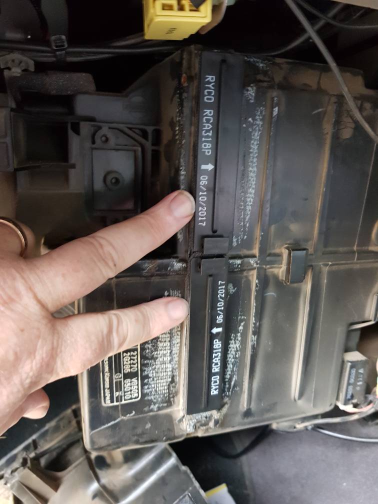

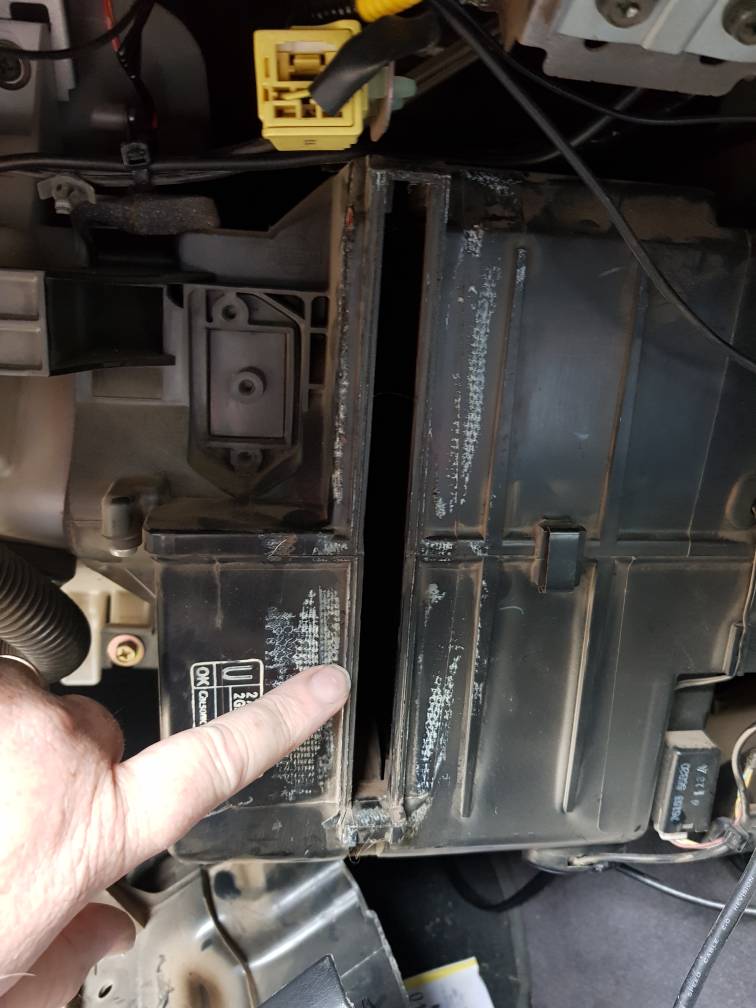

    Soni have finally sorted this out today. I had a go a couple of years ago and cut the slot but bought the wrong filter.
    I pulled the glove box out to change rear cameras and while its out i got this sorted.
    So using this thread i went into Repco and got a price for the right Ryco Cabin filter. $96! WTF!! So while still in Repco i called Nissan and got a price for OEM. $60.... spoke to old mate at Repco and he was gobsmacked. I told him to have another go.... how does $40 sound? Be in tomorrow! Sold.
    So a couple of important things i learned.

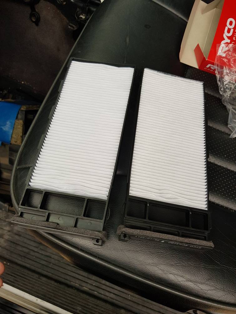

    The filter is actually a 2 piece split filter.
    The filters sit on top of each other.
    Here is the slot you have to cut out with a sharp knife.
    2 Filters
    Now one side of the filters has a little raised face, kind of castlated. You need to fit the top filter first and it goes in then up into position. Then the bottom slides in. Castles to the top ans bottom ans they lock in.
    Check how the labels look.

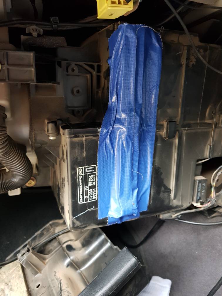

    Then 3 layers of gaffa tape holds them in.
    Easy as. 5 minutes or less to fit. The entire glove box is held in by 7 Phillips head screws and it drops out in a couple of minutes.

    No metal clip to secure the two filters in?
    Gaffa tape works a treat. They're not going anywhere
