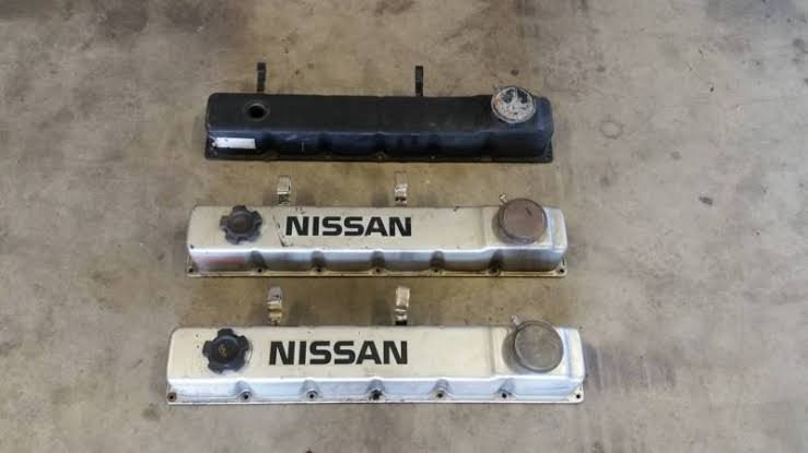

    Cheers Nicco! Hey with the sticker you print can you only do vinyl or can you use other materials?
    not sure, what do you want to cut and ill let you know if i can cut it lol
    Something to withstand engine bay temps. I wanna get a new sticker printed for the rocker cover like this one.
    Holy shit lol, mine is apparently good for 380nm but it won't come close
    ill ask at the local supplier if they do high temp stuff. may be better cutting the reverse logo(as in the borders of the letters) then you spray painting high temp paint onto it?

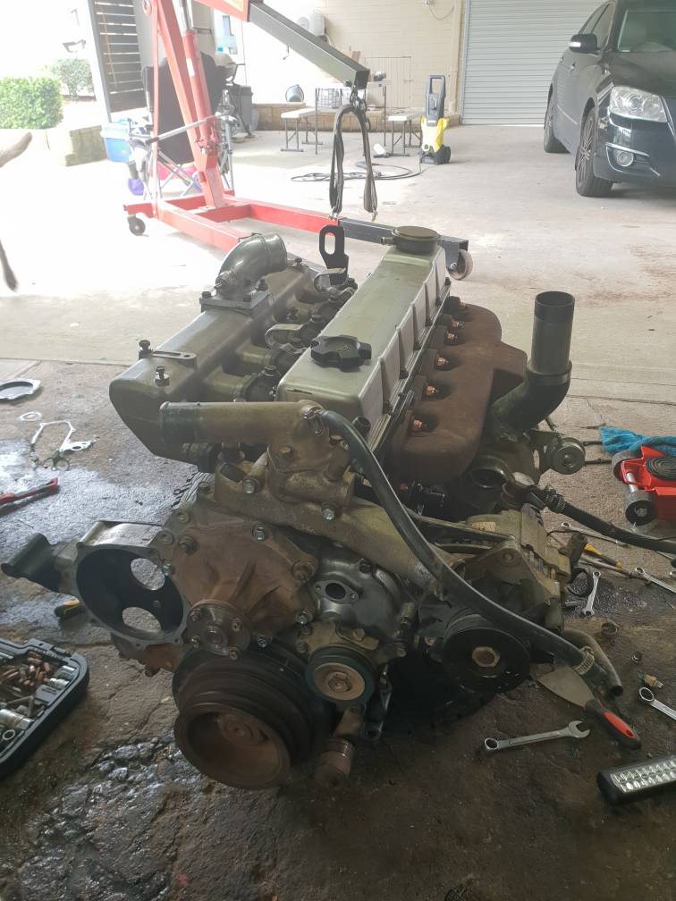

  13. #1070
    15,849
    7,305
    Cheers Daz!
    This is where I am at now. Not a lot more to go.
    I need to grind the crank hole out on my sandwich plate to fit the larger crank of the turbo motor.
    Need to install fuel pump and the lines and injectors.
    Flywheel and clutch
    Vac pump when it shows up.
    I need a couple of adaptors for turbo oil feed and a new drain hose.
    Will need to get an oil feed hose made for the vac pump
    I am going to relocate the vac canister to the drivers side.
    5mm spacer to be made for the tacho sensor
