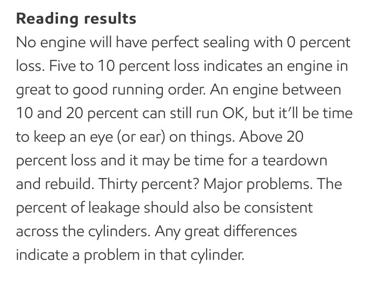

    @PeeBee old mate, new to me and obviously haven’t bought an ‘LDT’ kit yet so soon as was kindly advised from the Blokes.
    Cutout below from the link found trying to learn:
    Would there be a time period to consider versus percentage loss I should be working too?
    The link found is confusing me a little as I’m sure over extended time periods all perfect cylinders would leak eventually?
    Cheers!

    Mark, we typically leak test compressors and the like over night, however am unsure if the tolerances are the same, maybe @nissannewby could assist or @garrett?
    Reading the procedure suggests the results should be fairly instant, as you are testing each leak point then moving onto the next cylinder.

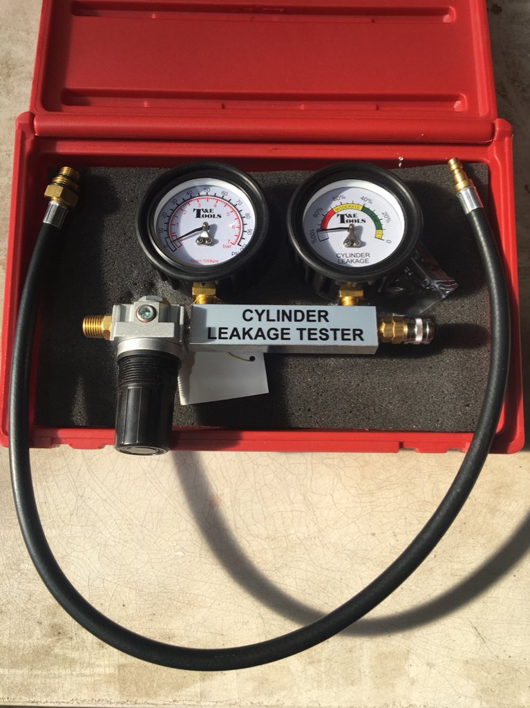

    Slowly but surely getting there, Leak Down Tester arrived this week, needs some diesel modifications/adaptations made though.
    https://youtu.be/0tZNh9dEt00
    Instructions below for anyone else interested as I too never knew this pinpoint/isolating test existed.
