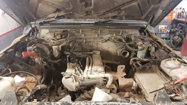

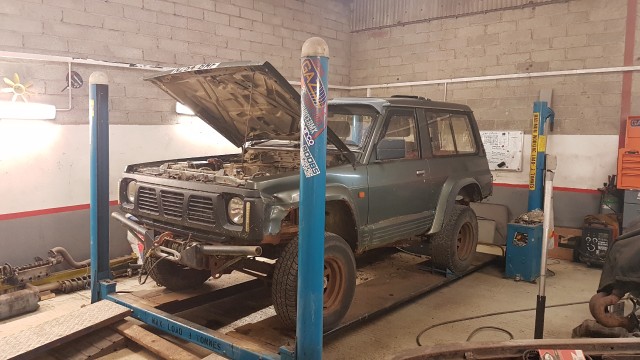

    Any road up, ere it is on the lift at ground zero. By the way it started up with a good battery and two glow plug cycles
    Crusty bits abound , including a rather nasty air cooled rear chassis leg
    Started off with a gallon of WD40 and all my knuckles. 2 hours in and the WD40 is running low and I'm down a knuckle.
    Trim removal etc

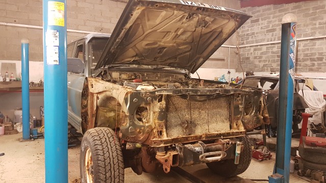

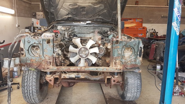

    Wing off and inner wing area not too bad and certainly fixable. Winch tray proving a bit more of a challenge but getting there.

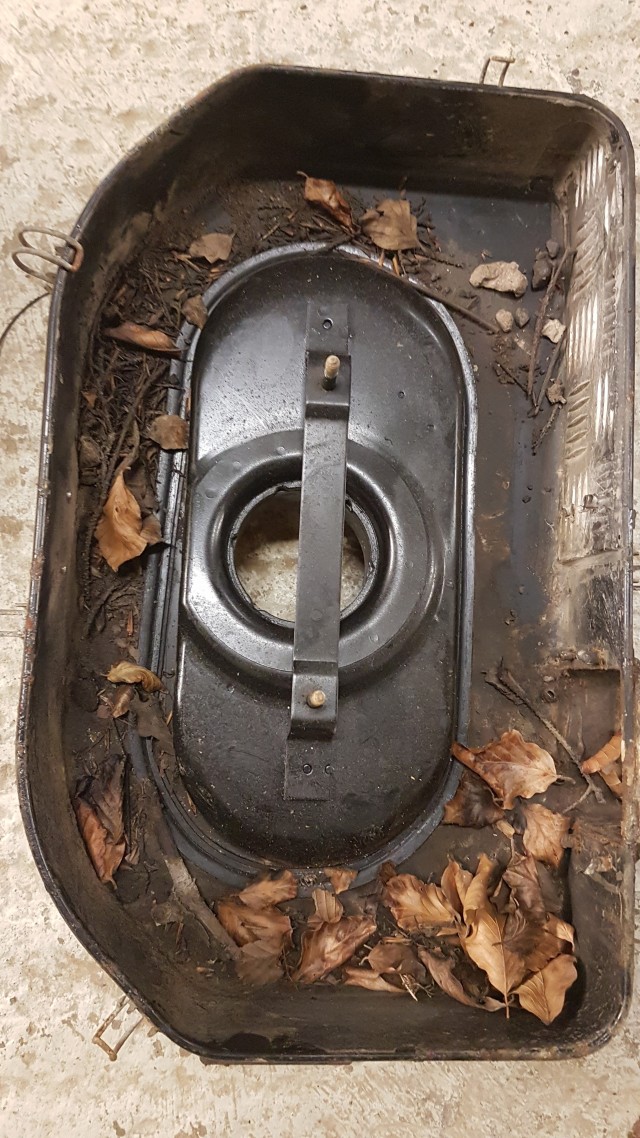

    Air box provided some nice dry kindling and some random stones.
    N/S wing off and winch tray out.
    More rust exposing itself but again, fixable.

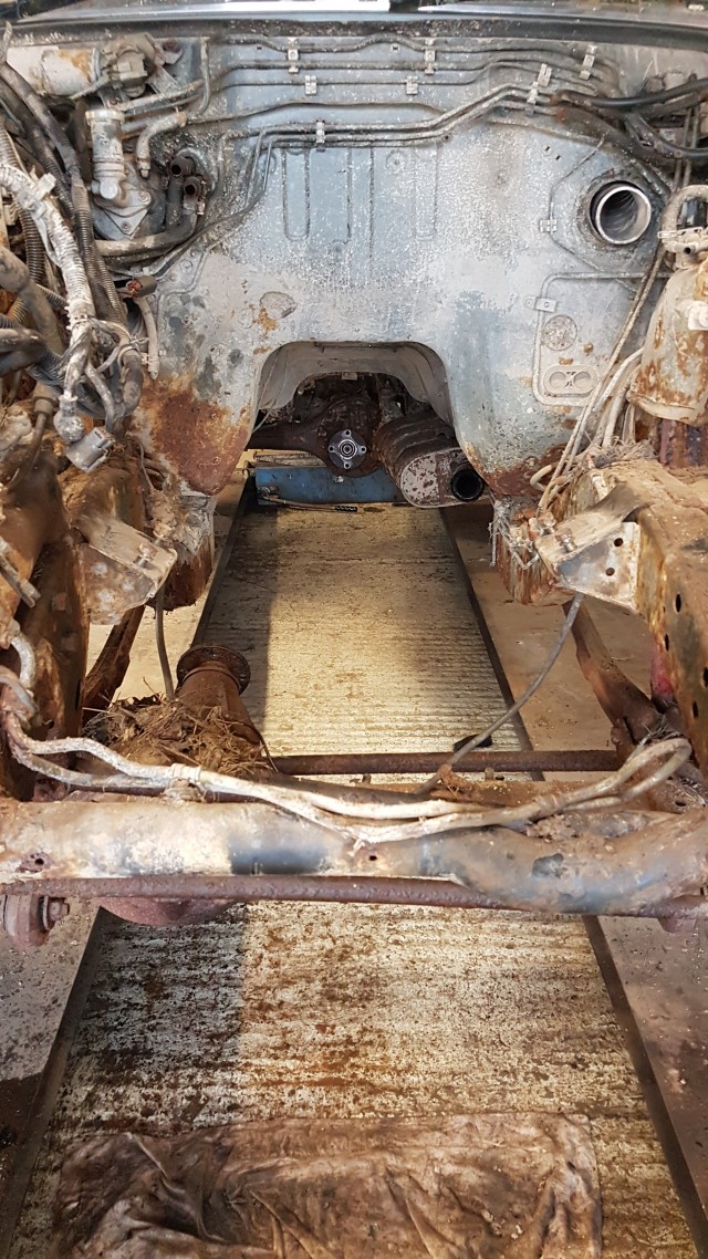

    Don't worry, you won't see this engine bay in this state again.

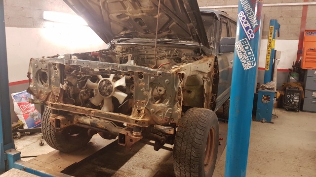

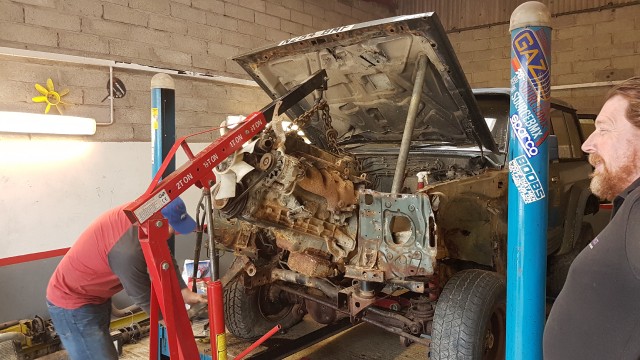

    Due to ht restrictions of our sloping floor and 4 post lift set up , decided to get the slam panel off to make engine removal easier. Drilled out the spot welds and boom engine access time.
    God knows how much this thing weighs but it does have it's own gravitational pull. We also found the working limit of the engine hoist. Had to put my big friends on the high end of the hoist lol

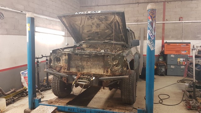

    Still couldn't quite get it high enough so cut the rad cross member off too. Suprise suprise it offered little resistance.

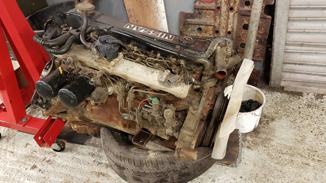

    It came out eventually and attracted the earth back up to meet it

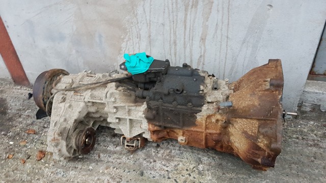

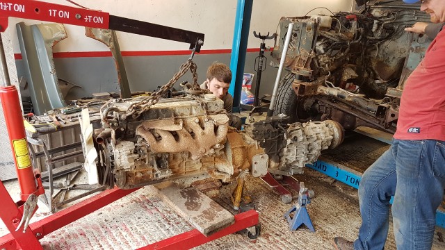

    Splitting the box.
    Look at the size of that hole, it's like the Mersey Tunnel
    One old 4.2 safely stored in a tyre waiting for it's new owner.
    I'm keeping the box though, so you'll hear me asking for top tips on servicing that beastie soon enough.

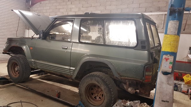

    Y60 Patrol 4.2 d SWB in puke green
    2" body lift, 2" pedders suspension lift, 35" Simex muds on excel 16" alloys, needs a turbo :/
