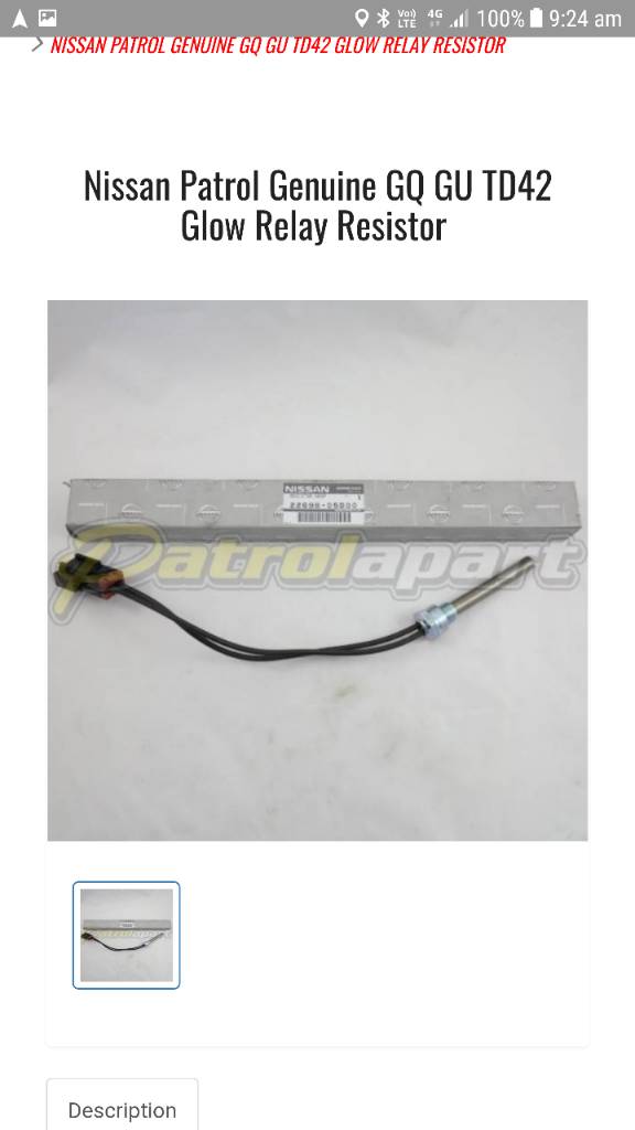

    What is this that is unplugged above the oil filter ? Got a photo the one above oil filters

    I have one too. No plugged into anything. While I have never bothered to find out I did remove it and had a look at it. It looks to be a manifold heater I think.

    Oh my plug is there but it’s never been plugged in 😂 don’t think I should tbh then ty

    Not sure, I just checked the parts catalogue and the description is dropping resistor. So not real sure what its supposed to do...

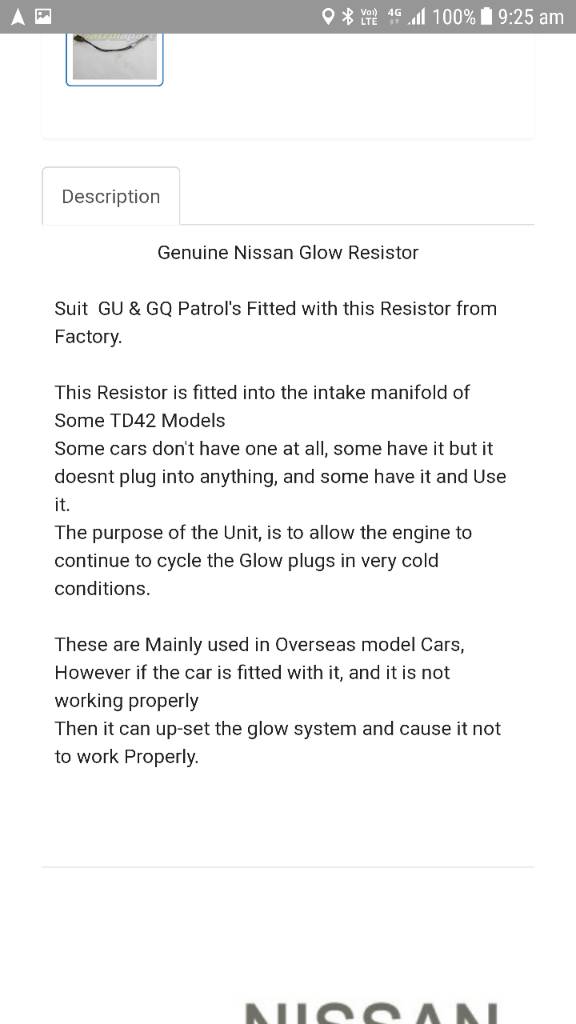

    Maybe ??

    Thats the mother!!!

    Wow thanks for that post good thing I live in Queensland won’t be plugging it back in👌
