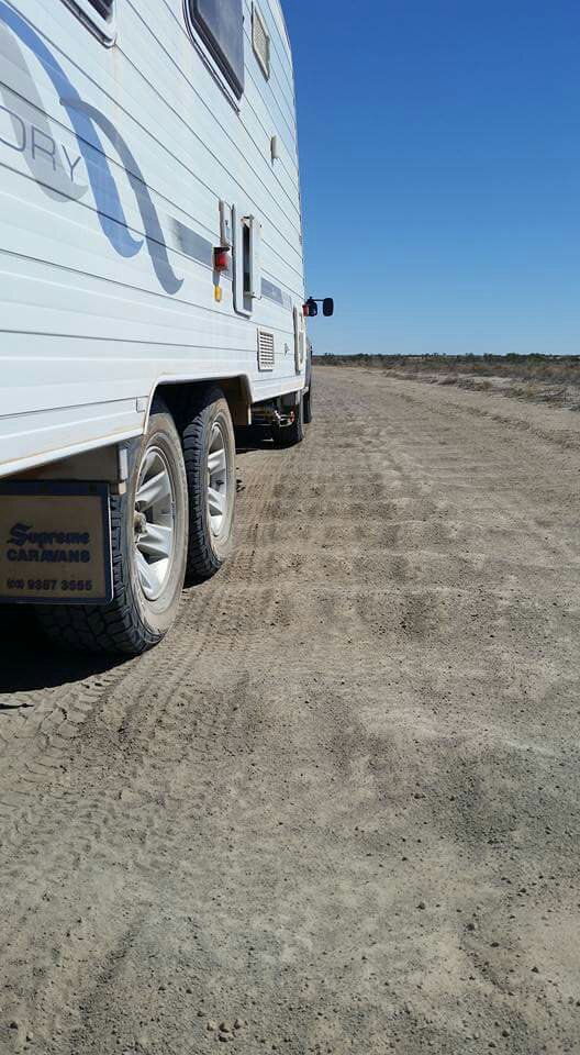

    Van and car at 35 all round , van just shy of 3 ton ,Innaminka end of Walkers , and not much over walking pace on these sections ) took a day and a half to get the Birdsville track ) , i would hate to see the damage form heat build up from side wall flex and speed if any lower ! Pumped em up to 40 on the hard stone at the Birdsville end .
