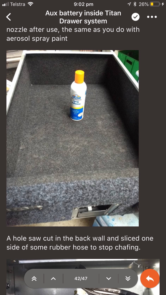

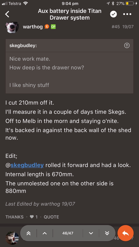

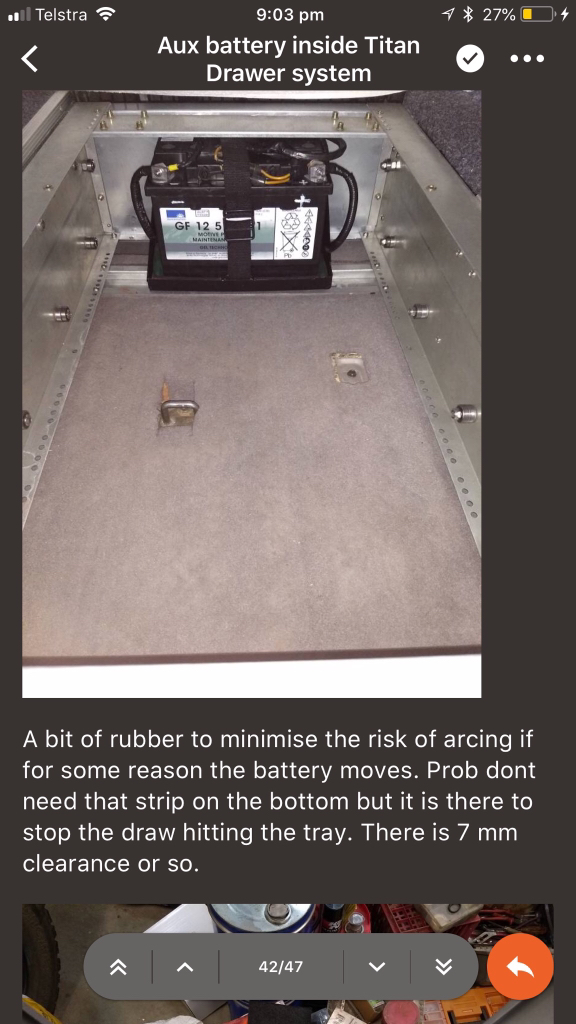

    Here are a few bits from Warty’s thread

    Very nice. Looks like he has a smaller battery and managed to use one of the floor brackets under the draws and the tray. There is no way my battery would have fit that way. I have like 5-7mm gap between terminal bolts and the top panel. Hence why I used that HV mat.
    Yes, he also bought that off me. He wanted something with a low profile and that was all we had in stock. It’s a 55ah Gel battery made in Germany. They cycle better than a normal battery so even though it’s smaller it will perform the same as a larger battery. They cost around $240
    He is happy with the result.

    I just re read 44 pages from Warty’s build. He repurposed the original battery tray from under the bonnet and mounted it on the existing frame of the draws. I prefer your idea because you can fit a bigger battery in.
    Either way lots of good info for others.
