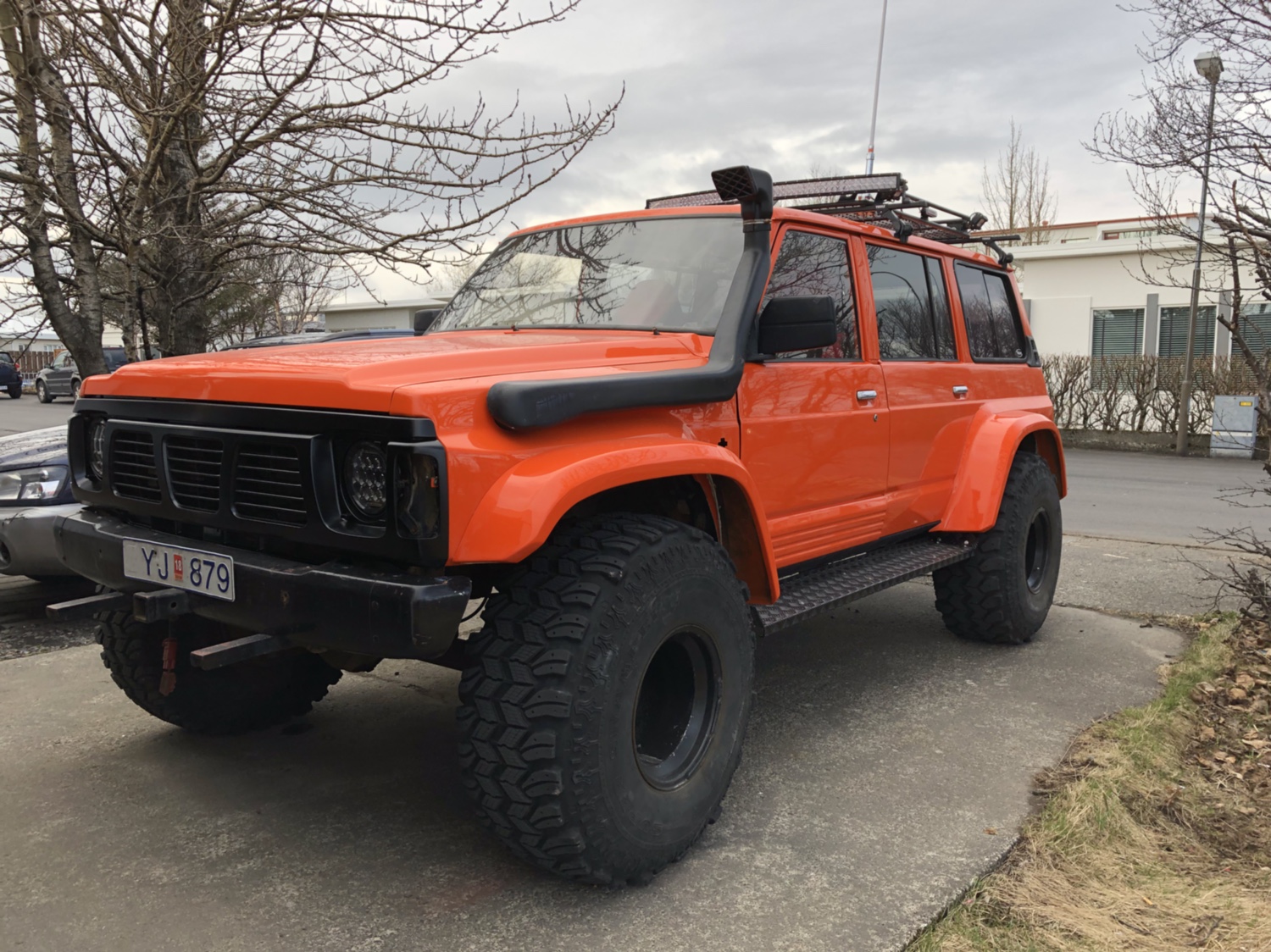

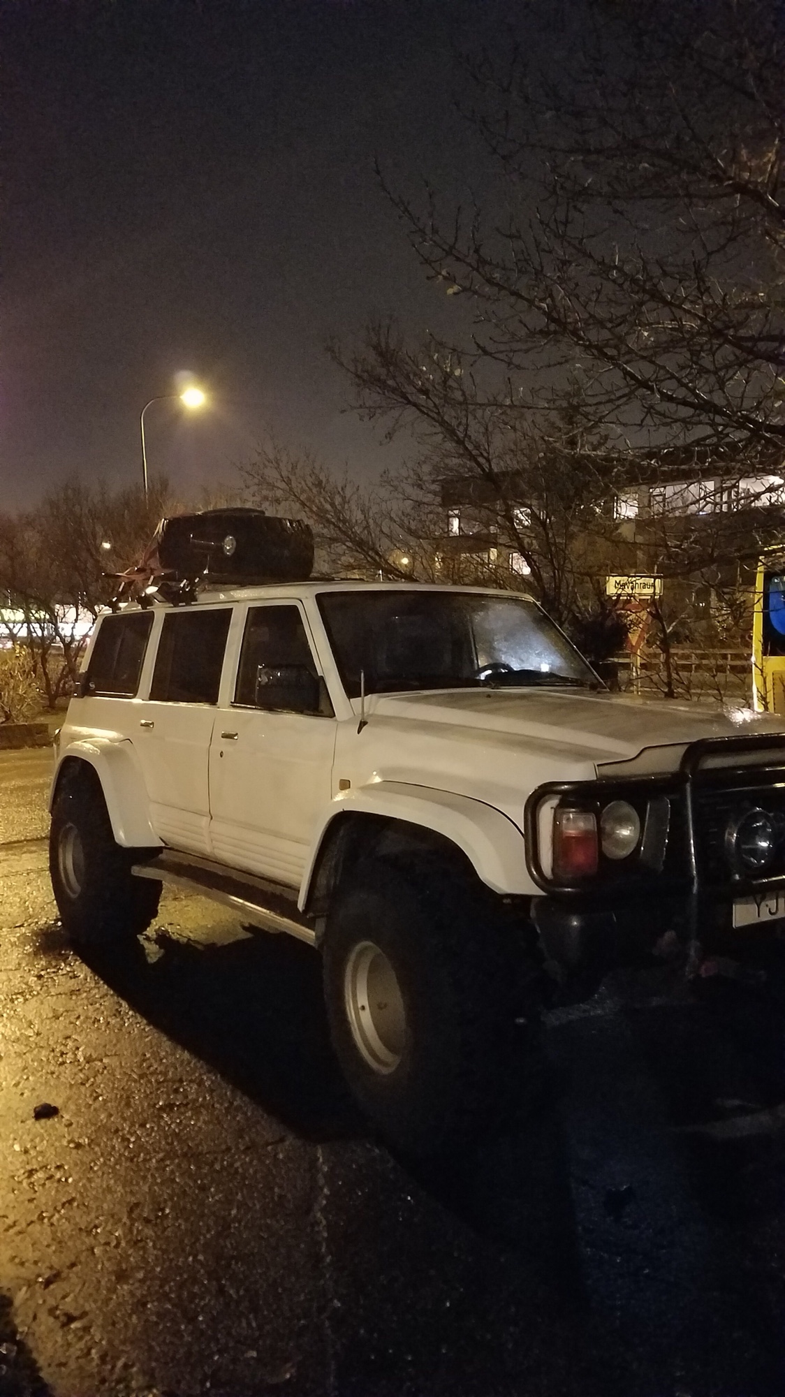

    So about 2 years ago I decided to finally get a GQ patrol. I had wanted one since driving one in 2009.
    The original plan was to just learn how to fix it up and have an offroad toy. Nothing extreeme right? Oh how litle did i know how badly the bug would bite me.
    This is the first pic i took of it after i got it.

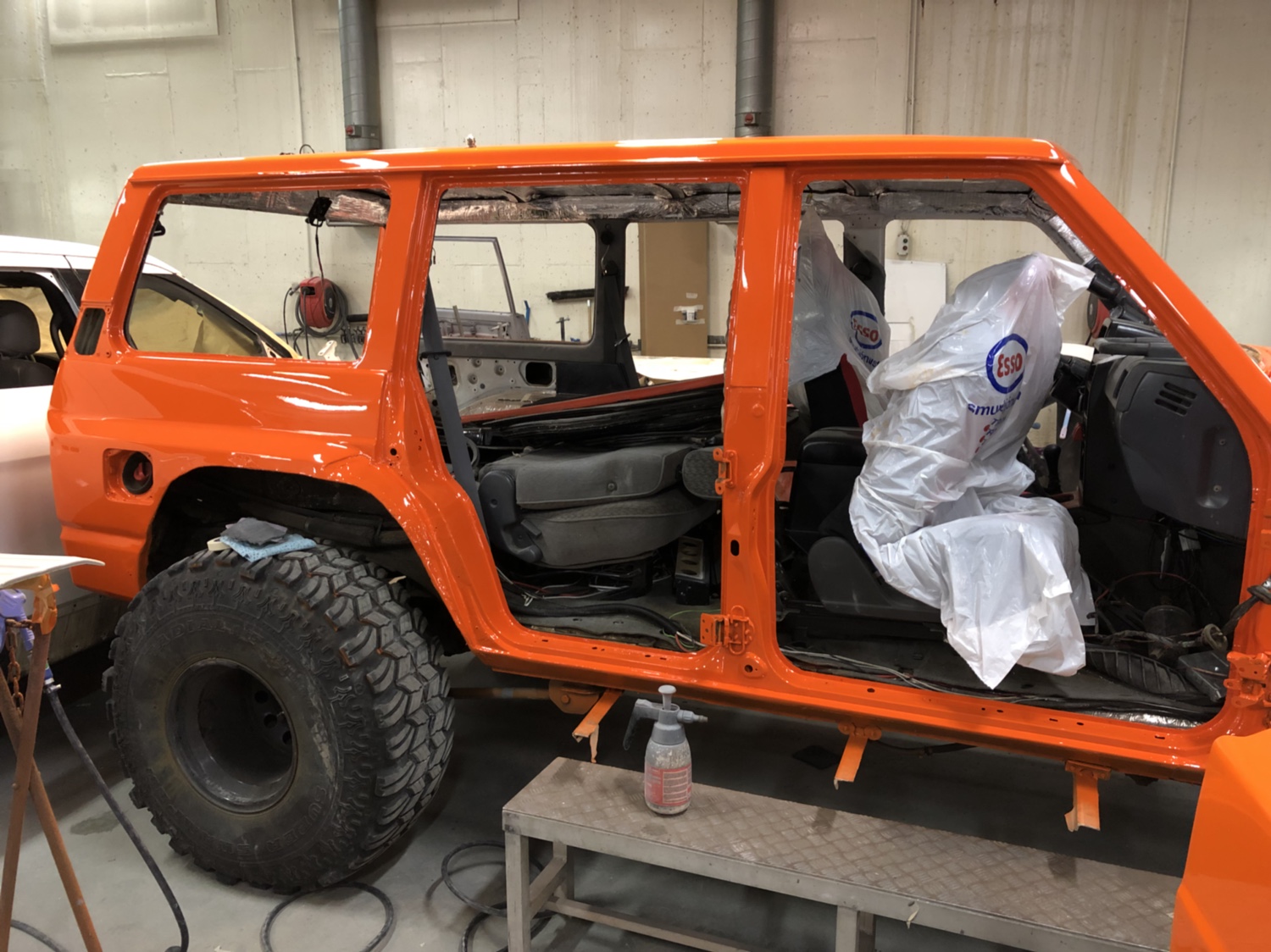

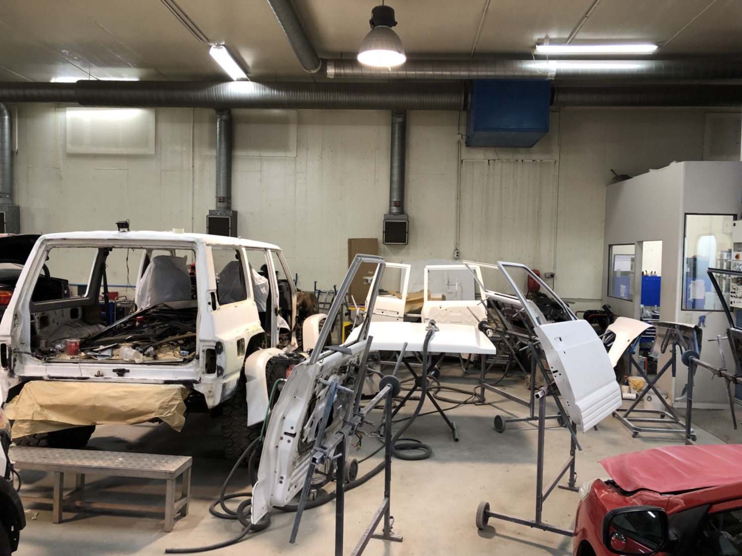

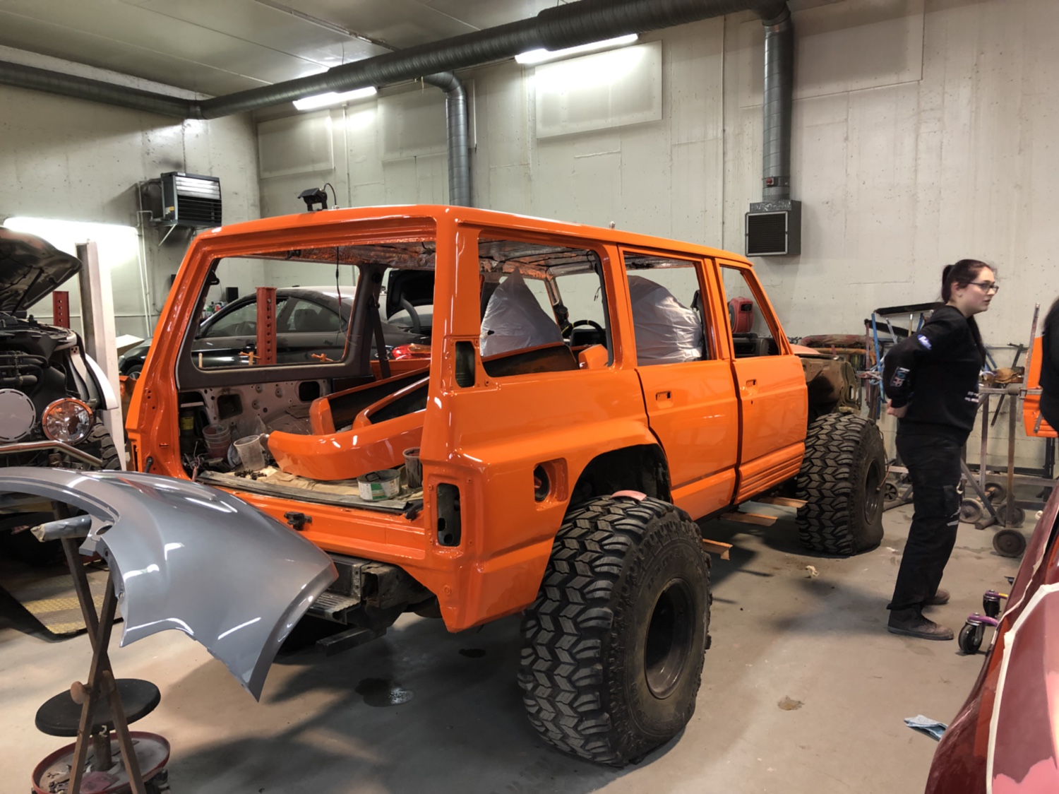

    Then i decided the color should be more “me”

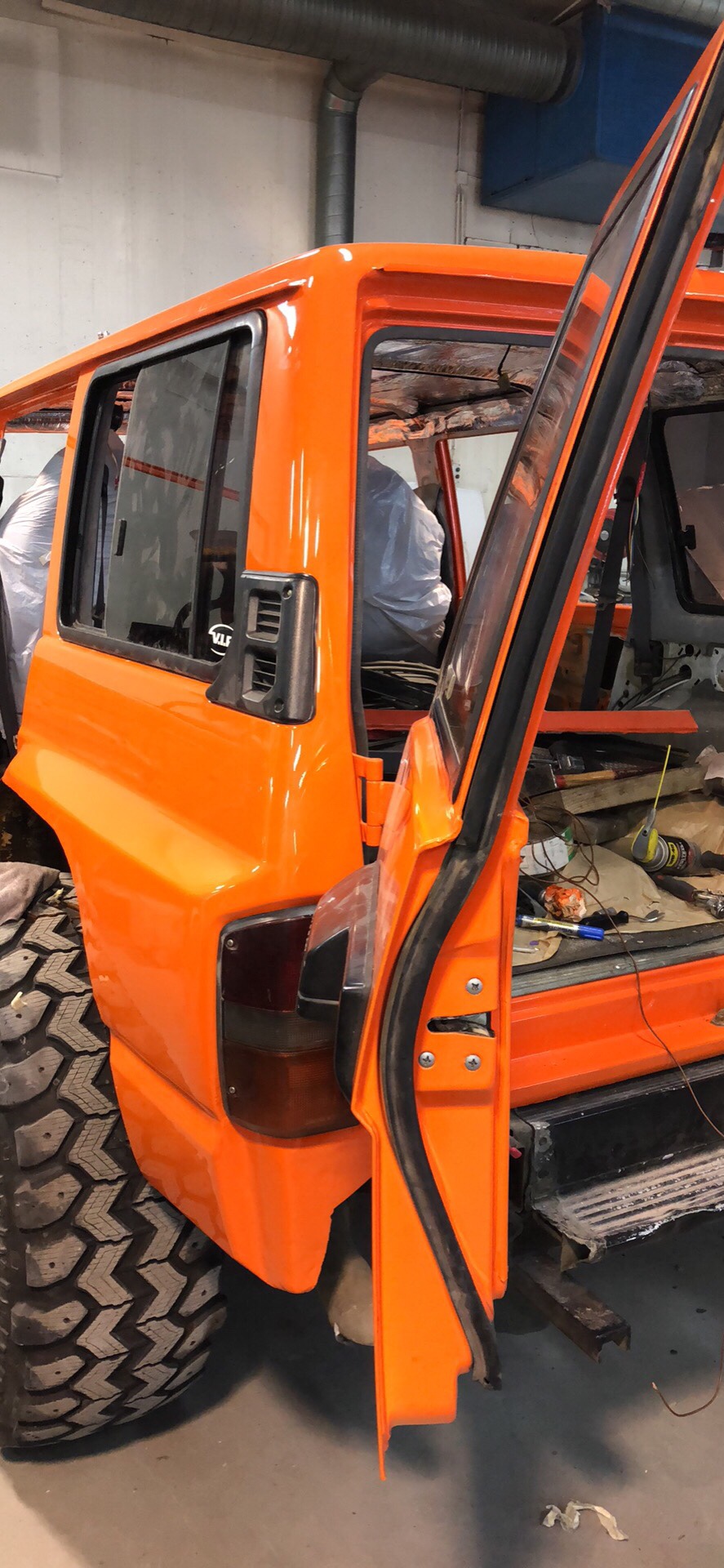

    So a full professional respray was next

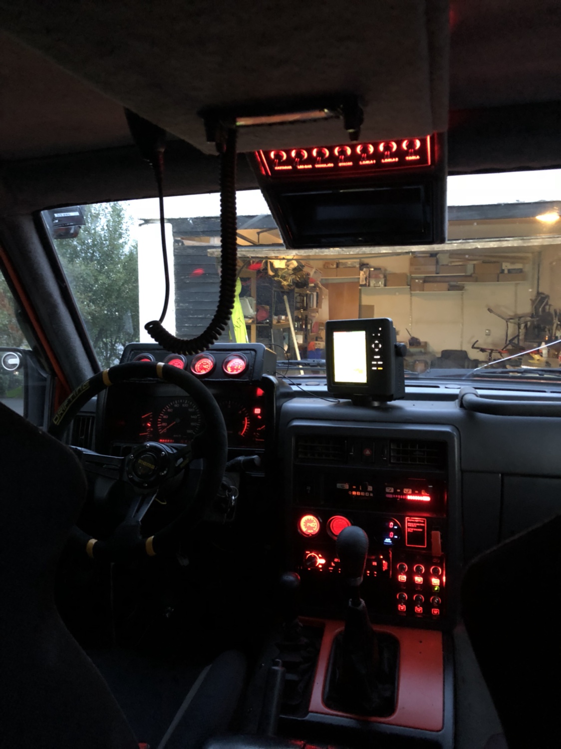

    After the paint all the interrior was sound insulated and recarpeted with a customized interrior

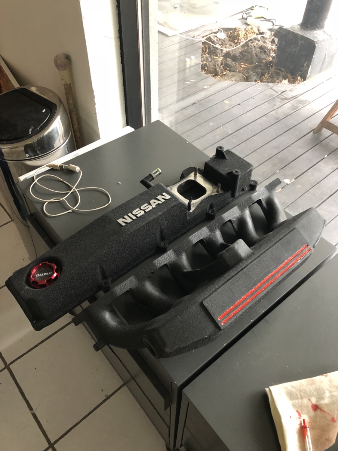

    And the engine bay got a new intercooler, rockercover, catchcan and a bullydog propane injection

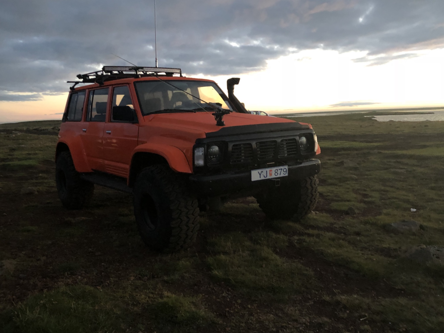

    So specs are:
    1997 GR Patrol (GR is the LHD version of the GQ)
    Rd28t engine with 306.000 kms on it
    Boost running about 18psi, stock turbo
    Frozenboost intercooler w2a (600hp rated)
    Bullydog propane injection
    Carter 4600hp liftpump
    Led bar 52”
    9” led spots
    6” 18w worklights
    Yellow strobe lights
    Reverse cam
    Rock cam
    2000w stereo with 4 6” speakers
    5” lift ome springs
    38” superswamper tires
    Subaru impresa front seats

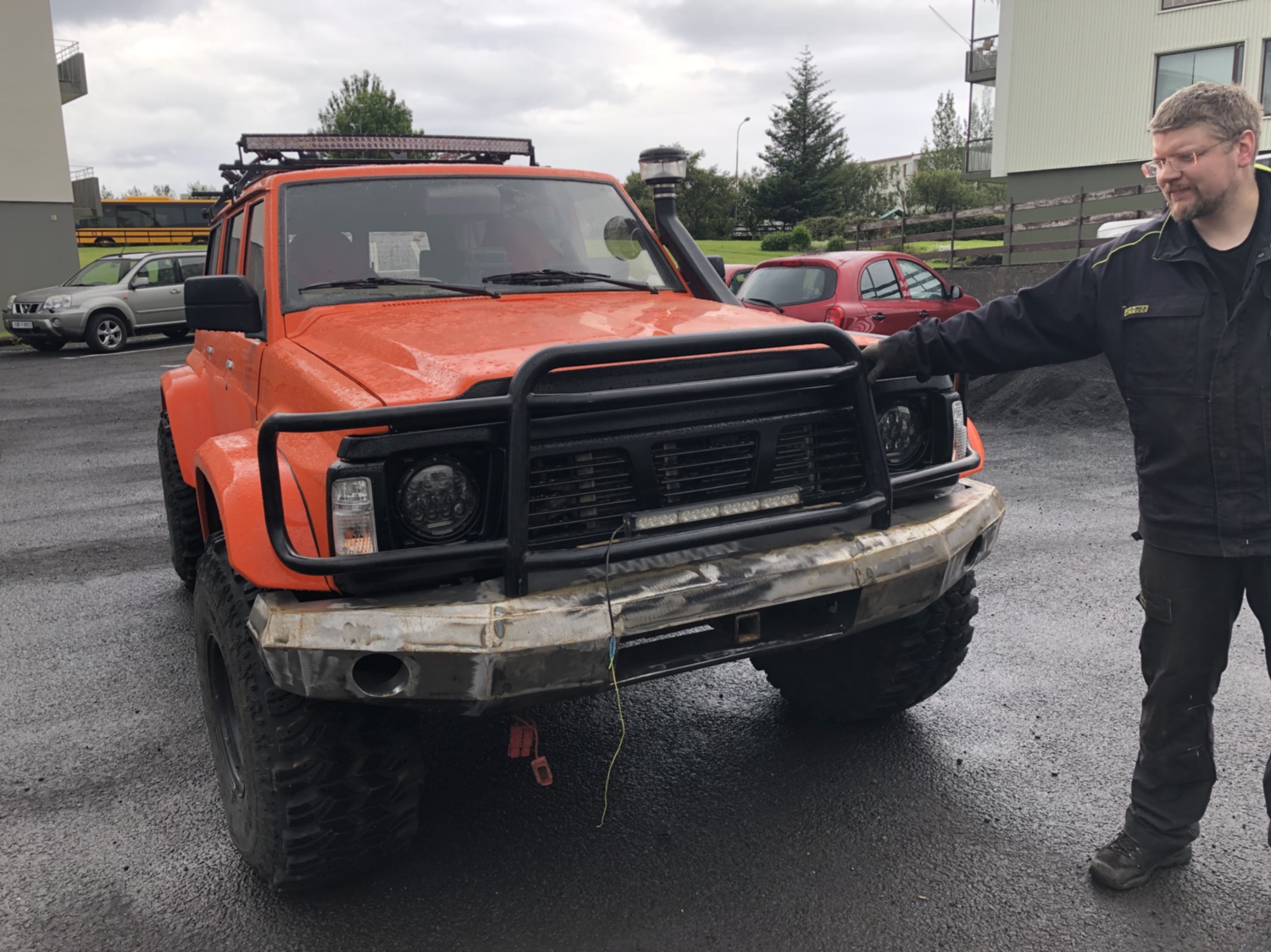

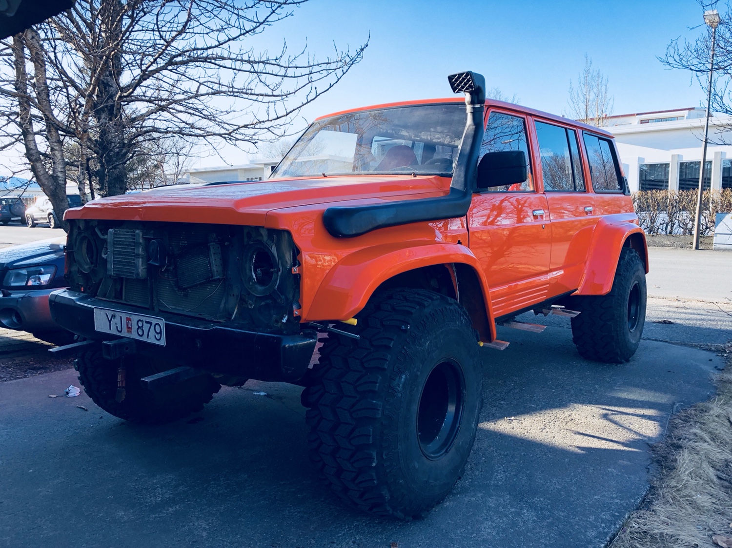

    Custom front bumper being built, w2a radiator goes in the center with fans behind it) and foglights. (Bullbar will be lower than in the pic)

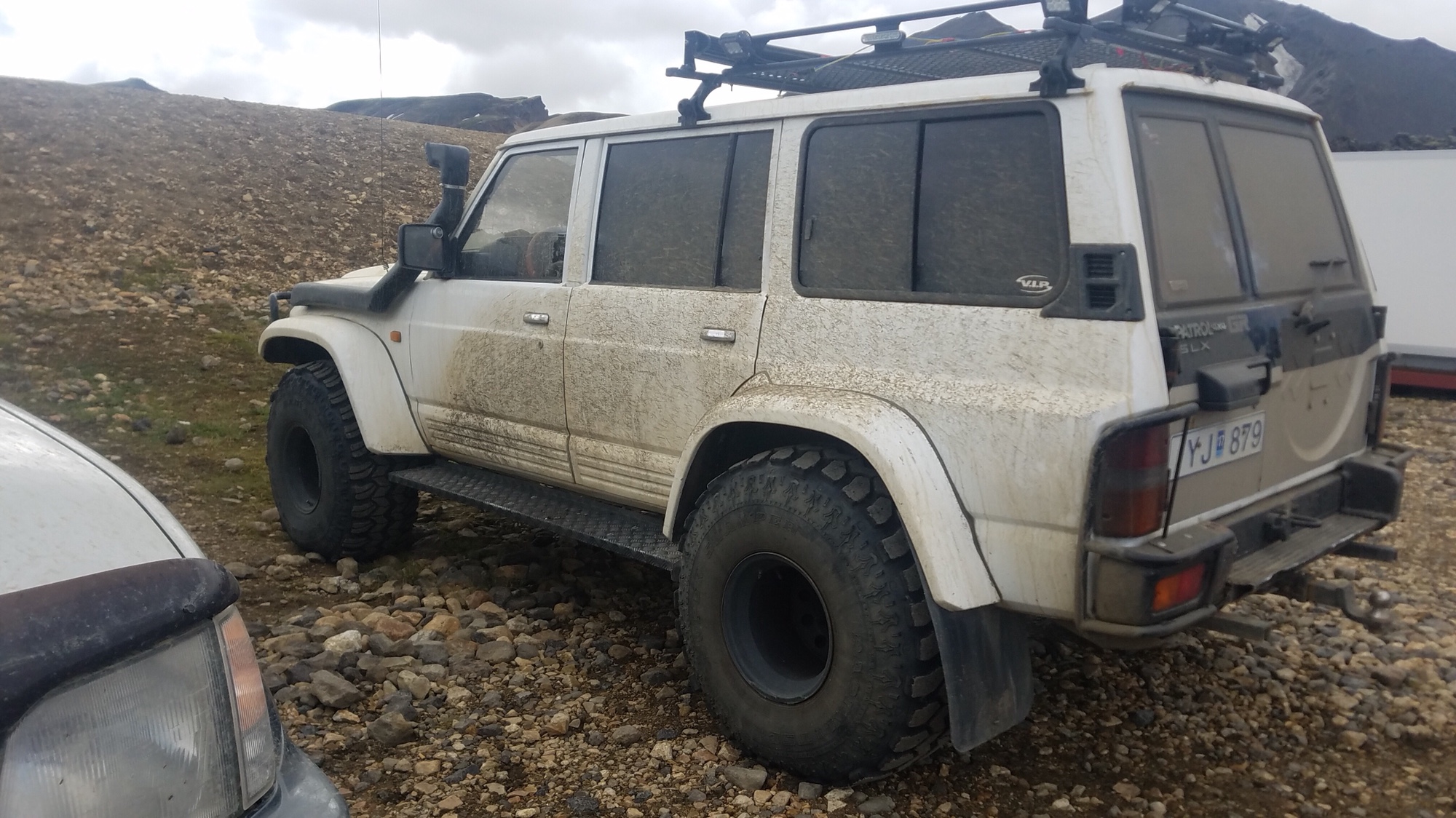

    Fishing trip in the highlands last weekend

  6. #4
    28,408
    13,850
    Awesome, love the colour mate!

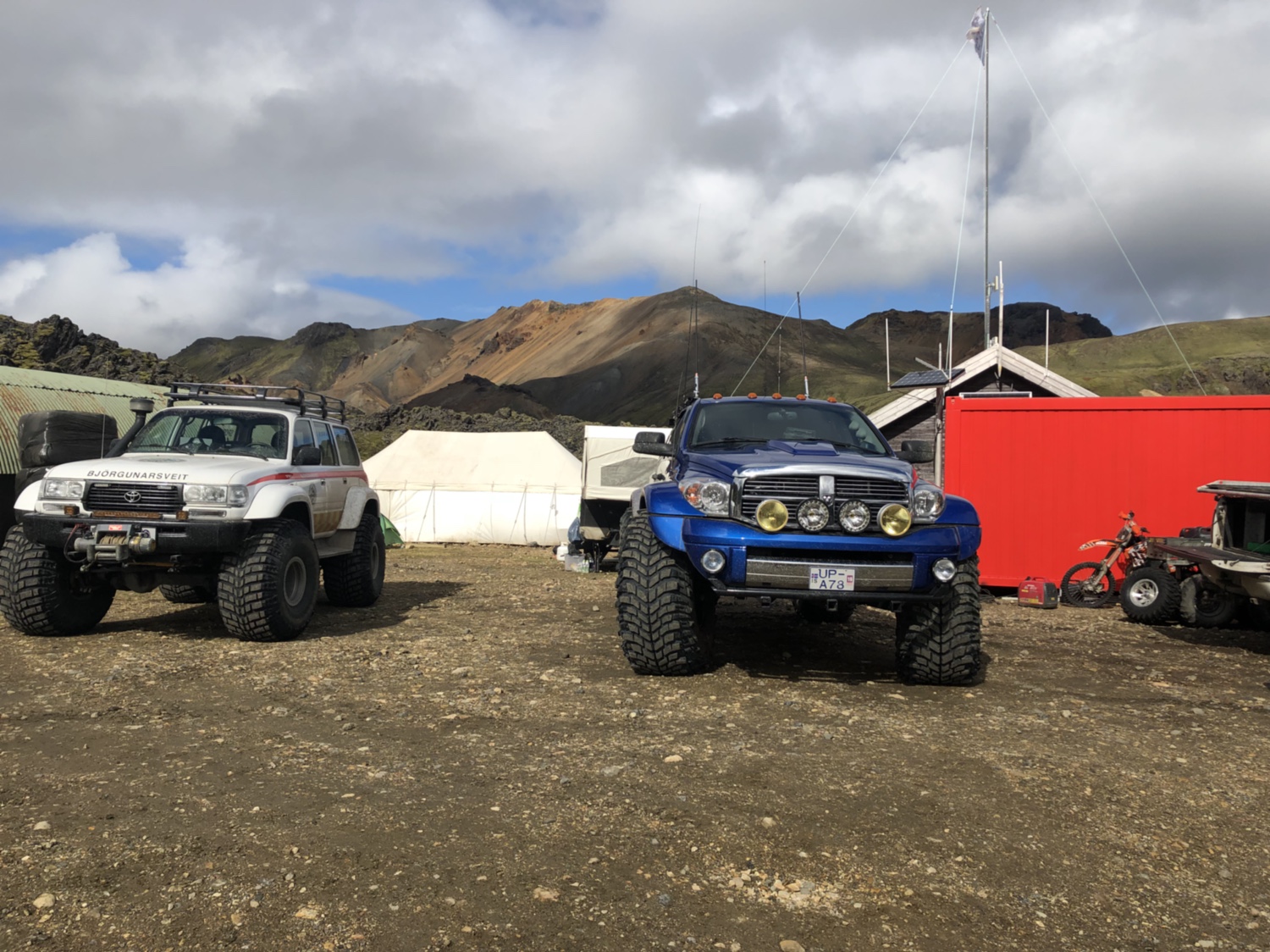

    Told ya mine was quite compact...
    Dodge ram has 54” tyres
    The LC80 is on 46”...
