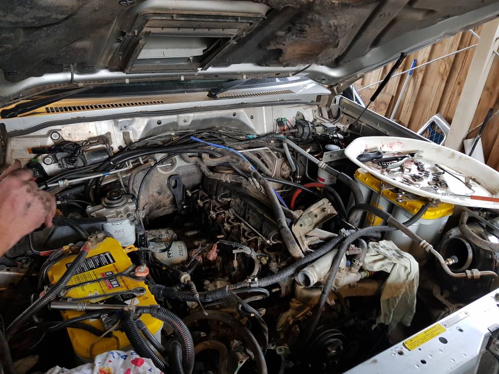

    So i have not been back here but damn have i been busy.

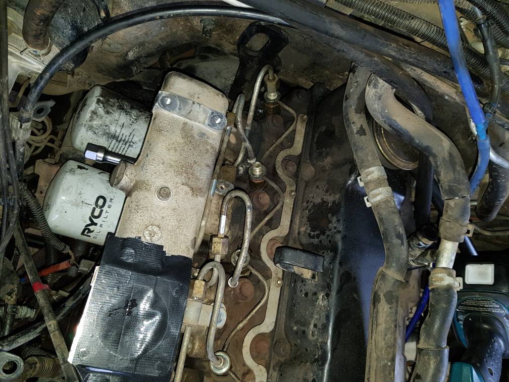

    Had a couple of huge weekends including hosting Matty and Rossco for 12 hours or more to fit this UFI 12mm pump.
    I took Rosscos advice and bit the bullet and decided to do the front mount cooler the same weekend cause, well, it won't take long right!!!!! Damn!!!
    Photo bomb
    Off with the front bar
    This was in the way as was the AC fan and PS Cooler

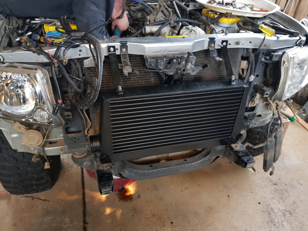

    Made a mount for the IC. Pretty pleased
    Removed the intake pipe as it needed to be rotated anyway to point the other way.

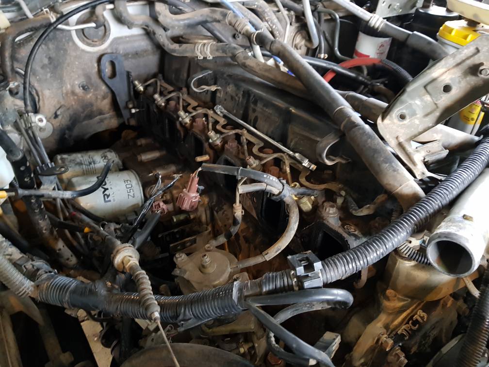

    I blocked the EGR about 8 years ago. Check this out!! I took the opportunity to fully remove it (cause you know, i had time!!)

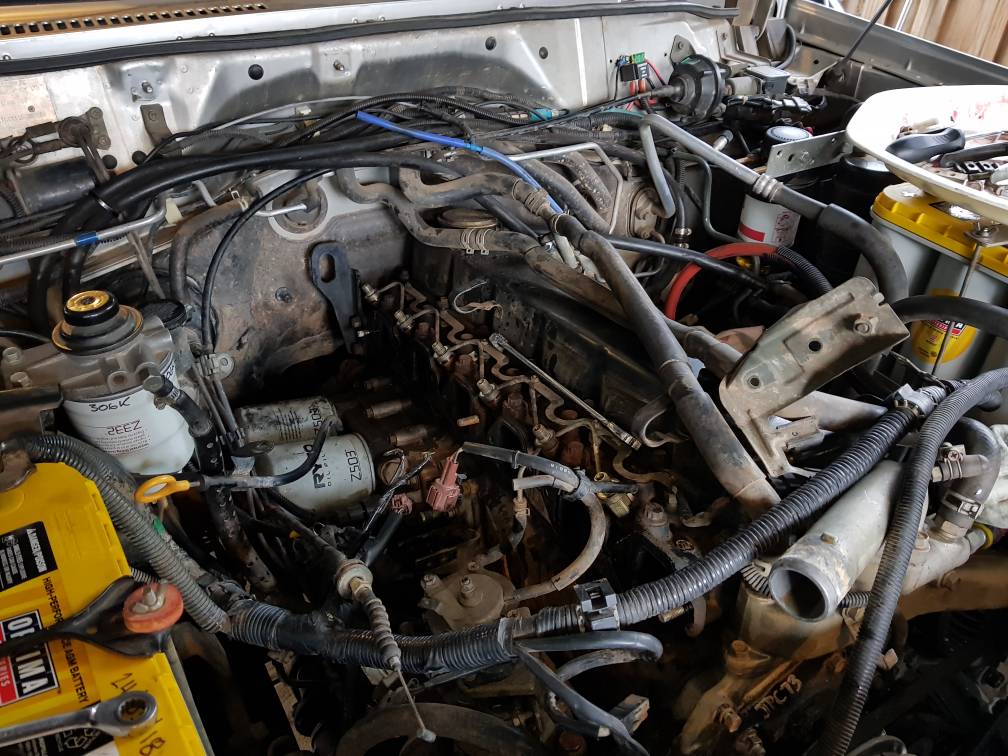

    Fan off. Radiator out. PS pump removed. Front cover to be removed.

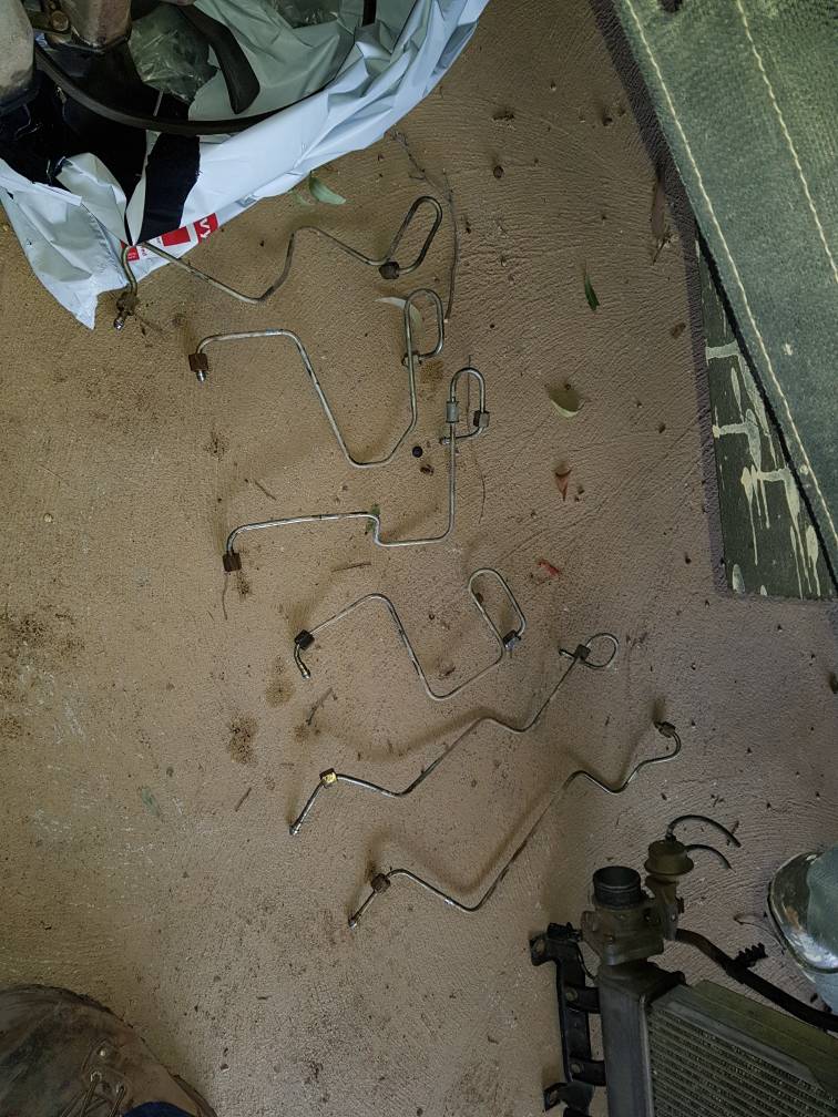

    Fuel rail off as i changed injectors too.

    Intake manifold came out too.

    Intake side i have fitted a 3" intercooler so have gone 76mm from turbo all the way to the intake. Damn it got busy!!!

    Flipped the IC upside down and bought another couple of elbows and we are done.
