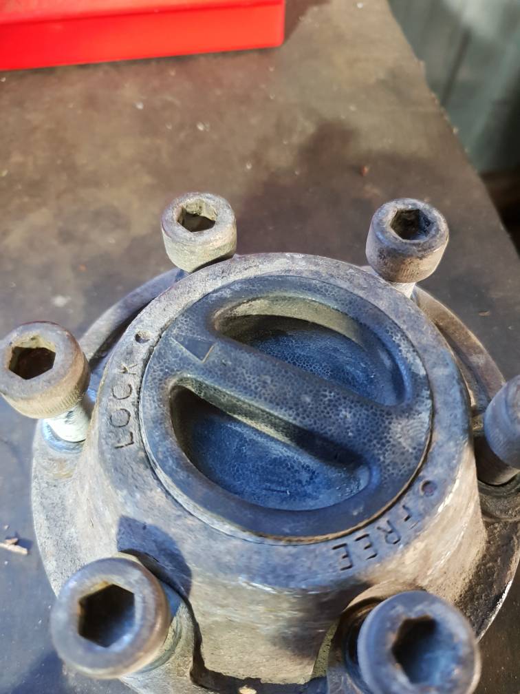

    Winnie, I replied to this post and it disappeared?? Anyway, my stock nissan hubs look like the bottom picture and are still fine since 1997. I run the outer ring washer as well. My brother ran the aisin hubs and they were rubbish - might have been a bad batch?
