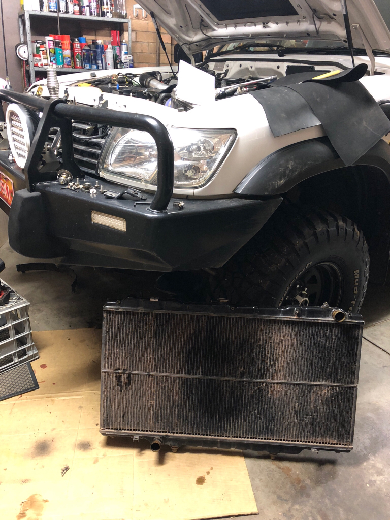

    Radiator out. Thermostat out.
    I’ll send the rad off for a clean in and out, and a Tridon high flow stat to go in. Now back to thinking of how to go about the wiring that is under the dash. Well. Was under the dash.
