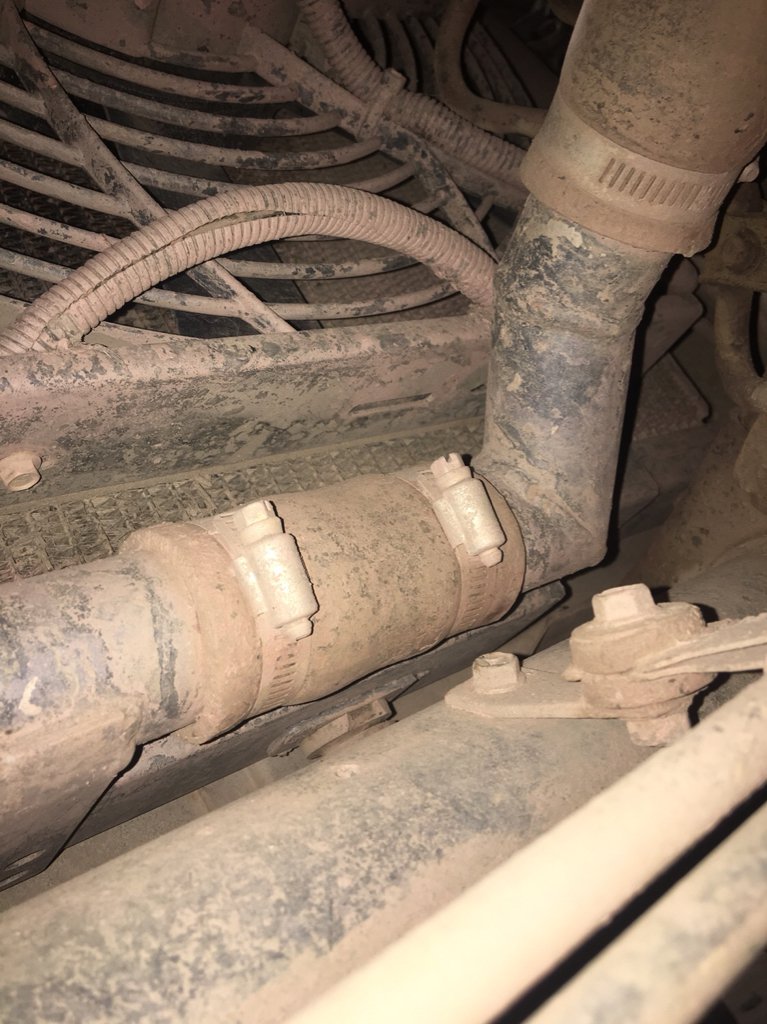

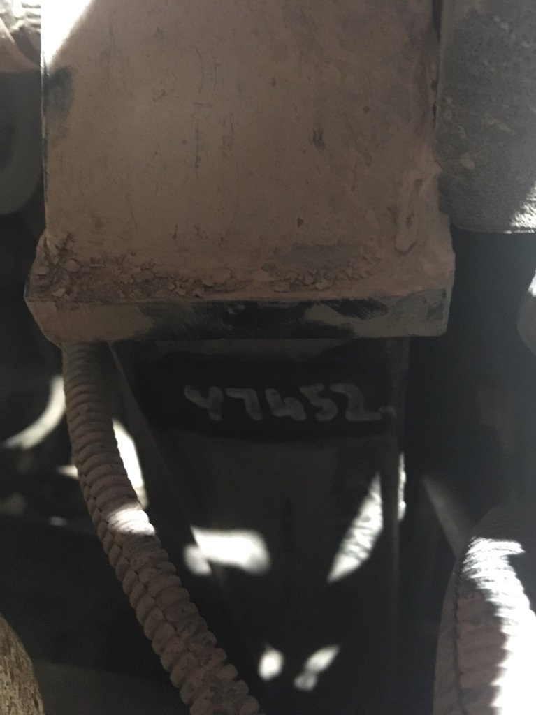

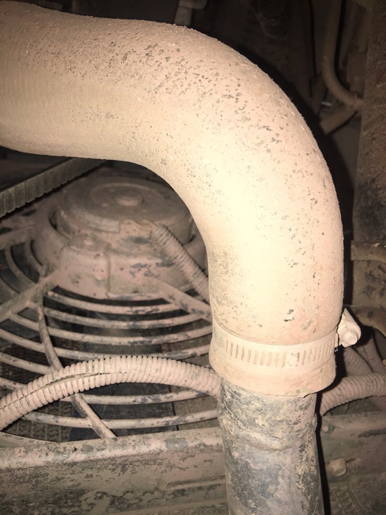

    ‘Y7452’
    My local builder also plumbed the bottom end from passenger side across to gain as much water crossing as possible.
    In their stock form (yanky trucks) I believe our 6.5 Chev’s have the TS top housing facing opposite so this is not needed for crossflow. Disregard my thermo fans, awesome in the slow bush tracks but not much chop on the highway hauling.
  8. #1046
    483 Post(s)
    A better radius bend bottom pipework setup would have been nicer though if done again!
