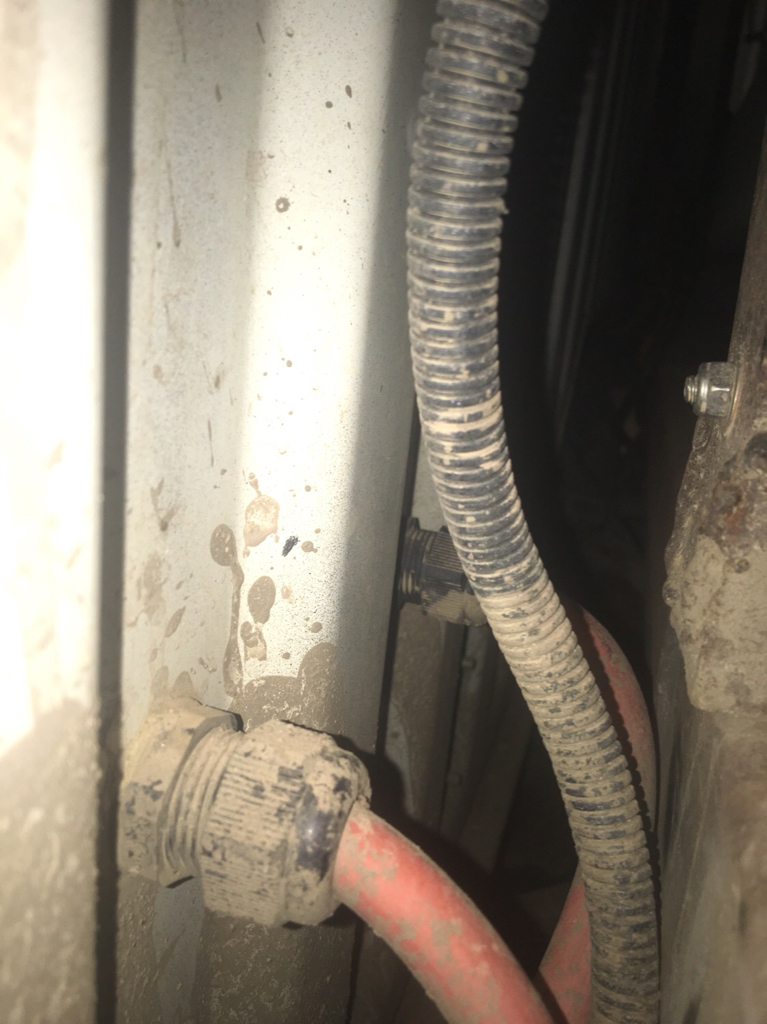

    This is what I did for the wiring to the lightbar on the roof rack.

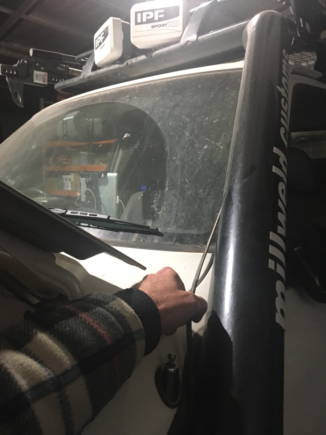

    Try and run some thin stiff wire down the hole, like fencing wire. Will be easy to maneuver than electrical wire. If you get it through, tape your wires to the fencing wire and pull it through.

    Yeah been doing that but keeps hitting stuff. The body seems to have multiple vertical layers through that corner pillar and not sure if there are some horizontal joins that creates compartments that prevents me getting the stiff wire through. Been poking wires up from inside and down from the outside and can't seem to get them to meet anywhere. Doing my head in.

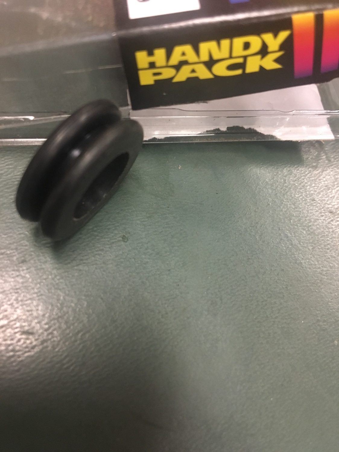

    Also as you mate have always been so weary about drilling through our beasts shells for mods we all need. Where penetrations have to go through as a minimum I was kindly educated to neatly drill,steel file and well seal steel thereafter. Grommets as a minimum too where possible: Thankfully have a great industrial sparky mate that helps out with the serious wire seals inside/outside:-)

    Yeah my wiring is more agricultural than industrial but I reckon it's going to work. Can't fit a grommet so the Old faithful silicon will have to do this time.
