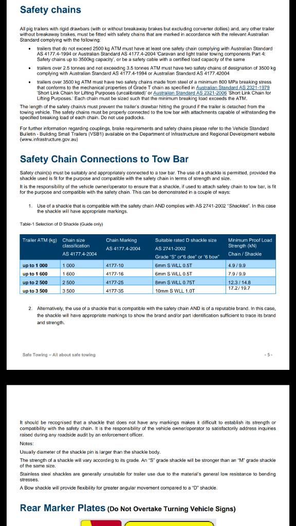

    Heres a screen shot of it relating to the shackles and chain

    It's complicated. Yes, there are formulas for recovery. They take into account weight being recovered, rolling resistance, terrain type, terrain angle, and a couple of other variables. The result is the pulling force required to get the crock out of where it is stuck. Army recovery mechs have used these formulas for many years. These calculations allow them to plan their recovery wrt equipment required, pull ratio, etc.
    As far as equipment rating is concerned, ET is correct IMHO. All rated recovery equipment is rated for lifting and includes large safety margins. It has been determined by the recovery industry (again mainly driven by the Army at the time) that these large safety margins are unworkable and unnecessary. Again ET is correct in stating that using lifting rating for recoveries (here we are talking trucks, tanks and vehicles with serious weights) it would be impossible for even two people to lift the equipment. (Even then, the Army's recovery tank has a "small" winch installed to allow the main winch cable, connected to the "BIG" winch, to be pulled into place).
    For this reason it was determined that recovery equipment would be rated by using 50% of the oringinal breaking strain. (An example would be a shackle with a one ton SWL and a safety factor of five would have a BS of 5 Ton. The recovery industry would use this 1 Ton shackle for a 2.5 Ton recovery).
    It has been many years since I have done this type of training and things may have changed, however, if you correctly use rated equipment, the chance of it failing would be close to zero. Also, as I have stated in previous posts, you should always use a snatch strap no higher than 8000 kg for normal vehicle recovery. This ensures that the snatch strap is the "fuse" in the system and if all else fails, it will break before bits are torn off a vehicle.
