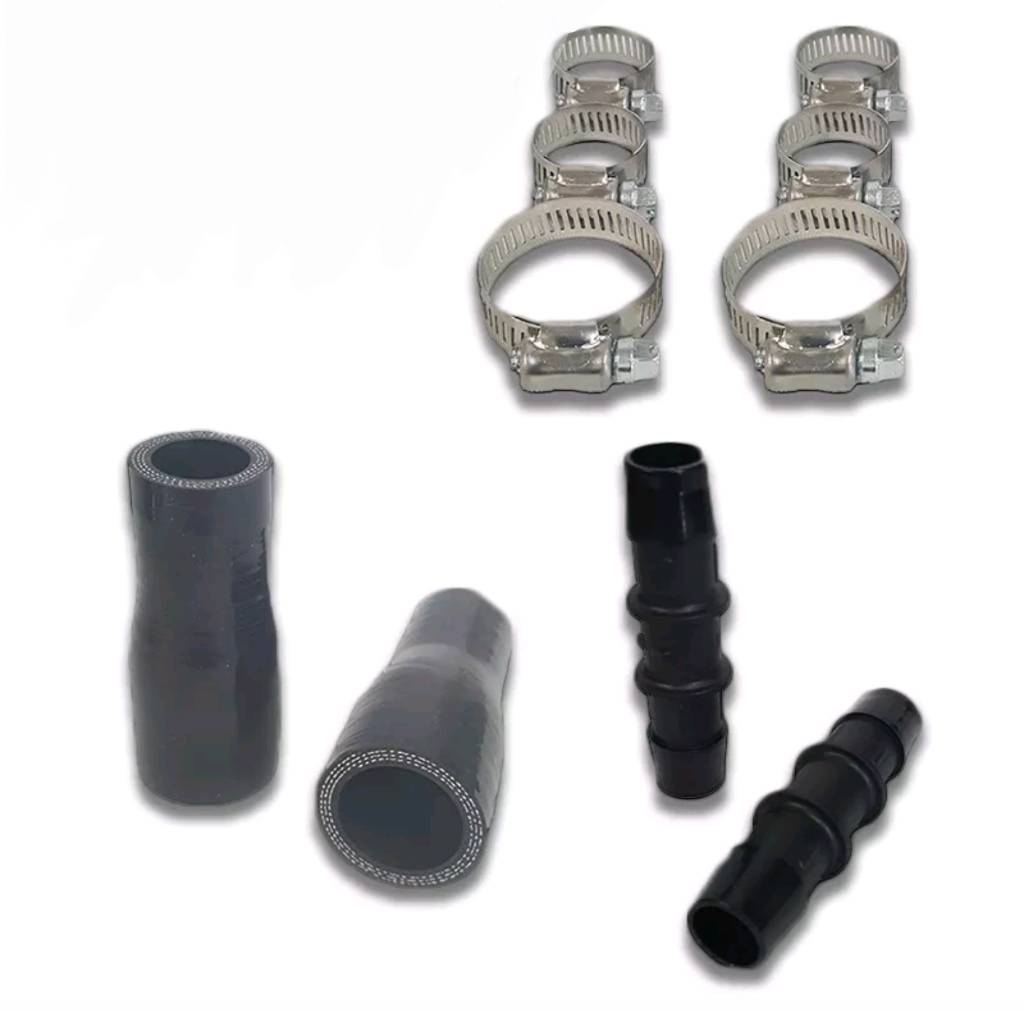

    I've just had a play with some reducers / hoses I've come up with in our diesel hydraulic mechanics work shop.
    One issue I'm slightly concerned about is the internal hose joiners greatly reduce the internal diameter of the hose . So when a joiner is inserted inside a 16mm hose, the hose gains a 11-12mm internal restriction. If that makes sense.
    Now I don't know what pressure this works under or whether or not this will be of any hindrance.
    I've got the reducing kit pictured below at home but the joiners internal passage is 10mm at most.
    Same joiners /bushes came with my Provent 200, works fine very low operating pressure and flow rate (restriction not a problem). Just been taking mine in and out over last couple of days fitted and adjusting actuator on stage 3 turbo and noted slight cracking at the larger dia of the reducer bush(all good though). For operating pressure, if interested, drain can open drain trap and put finger over end for indication.. My brkt made out of angle section cut from 150mm steel C-purlin (one leg longer in my case).
