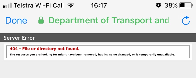

    Cheers Mike, ET’s kind link seems to error off my phone.
