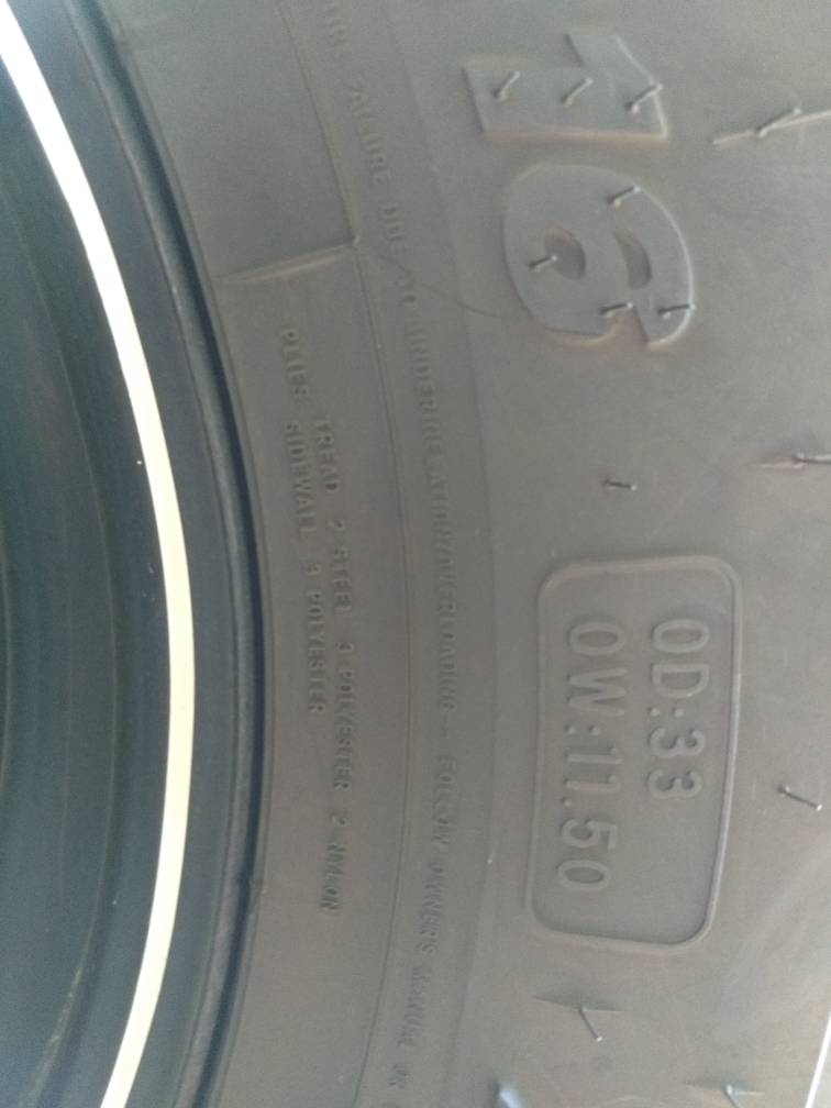

    What about tyres that have 3 or 4 ply etc but rate as equal to 10 ply. I seen alot of those. Are they legitimate in regards to strength of a true physical 10 ply?
  5. #15
    Advanced
    Jun 2015
    40
    46
    Thanked 29 Times in 18 Posts
    4 Post(s)

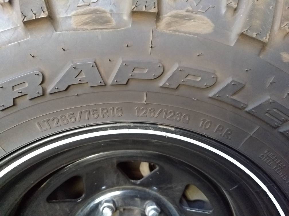

    Nitto trail grapplers have a 3 ply sidewall and a 10 ply rating.
    A heavy tyre with a stiff sidewall.
    A 10 ply rating does not mean a 10 ply sidewall.
    I'm not aware of any radial tyre with that many sidewall plys.
