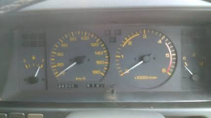

    15,848
    7,305
    There is more than 1 GQ dash. If yours looks like this then 12 o'clock is absolutely normal operating range.

  7. #7
    22,555
    14,474
    Forgot about those ones, would that ne a series 1 cluster though?

    on the right hand side of the speedo .......

    Quote Originally Posted by Tip12345 View Post
    As per the pic Winnie put up?
