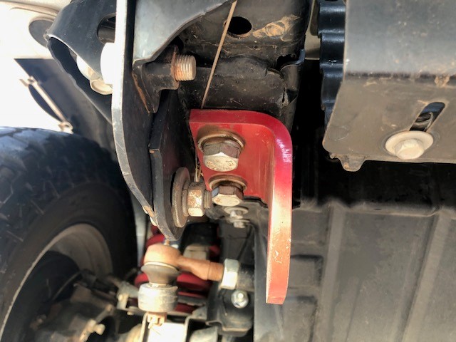

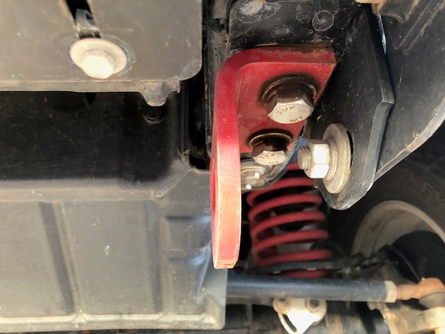

    I've got three dogs recovery points on my GU 2016 Legend series, they only use the two bolt holes as pictured below.
    2016 GU Legend Edition: 3505Kg GVM Upgrade and Stuff!

    Thanks for the photos - they look nice and neat / minimal size which is great.
    I have sent an email as per PM.
