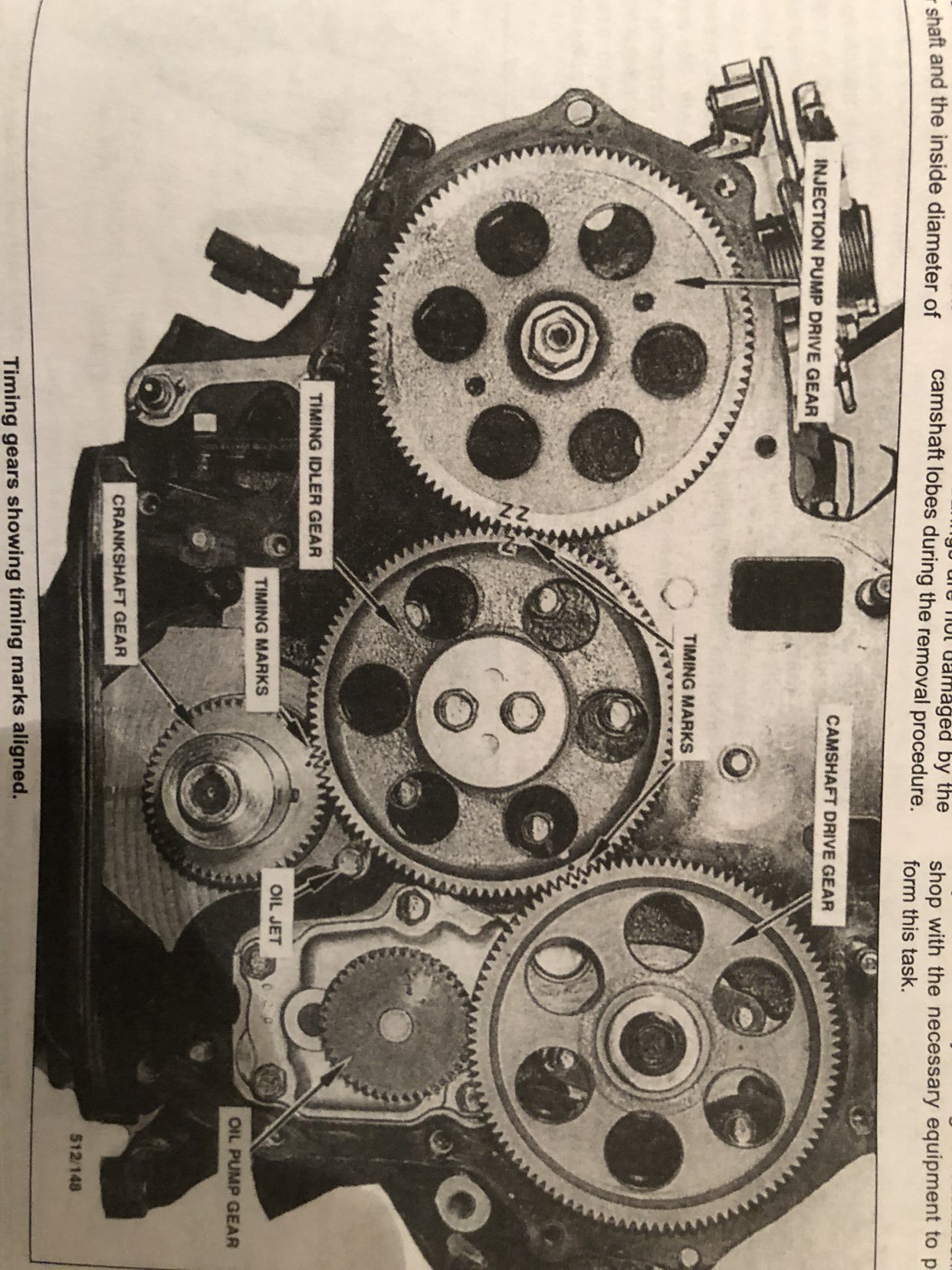

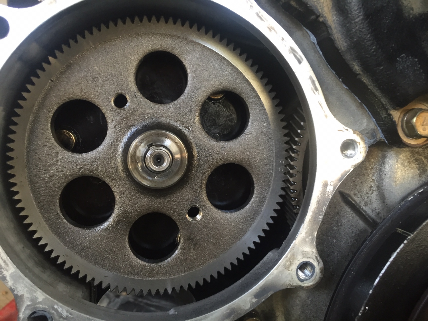

    Hey guys so was just out working on the motor and have just realised that I didn’t mark the position of the gear that turns the injector pump. Now the question is does it matter too much where the injector pump gear is. I know I need to mark all of the other gears for the crank and the cam and what not to get the timing right when the motor goes back together.

    They have marks on them, and do you have a manual?

    Injector pump cog Z line up in middle of main cog and make sure the key of ip is firmly in.
    Jack mate, definitely need manual mate and follow torque settings too, take your time and do it properly.
    Your timing will be way out too unless you get the tool or get it over to someone to time it as you're timing will be completely wrong mate.

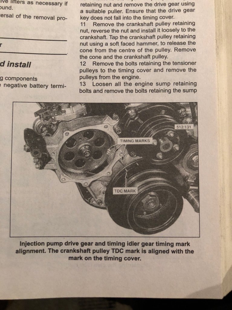

    Make sure the crank is tdc too by lining up the marks as per the side of my first photo too. Download the manual mate'

    Ok cool so line up the zz on the injector to the z on main crank

    Found it guys hahaha thank god for the Haynes manual

    Sorry for all the pictures but found the proper one
