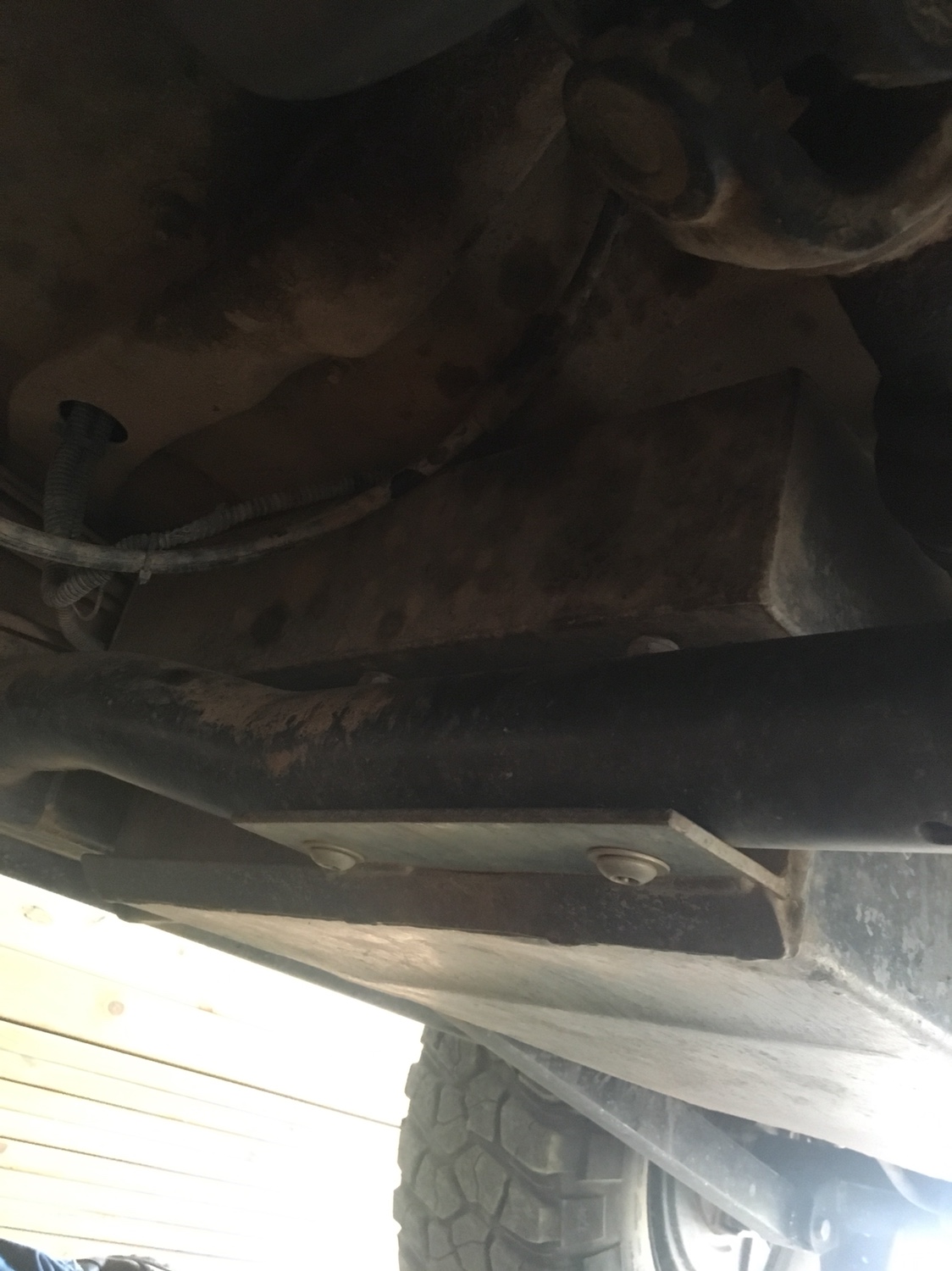

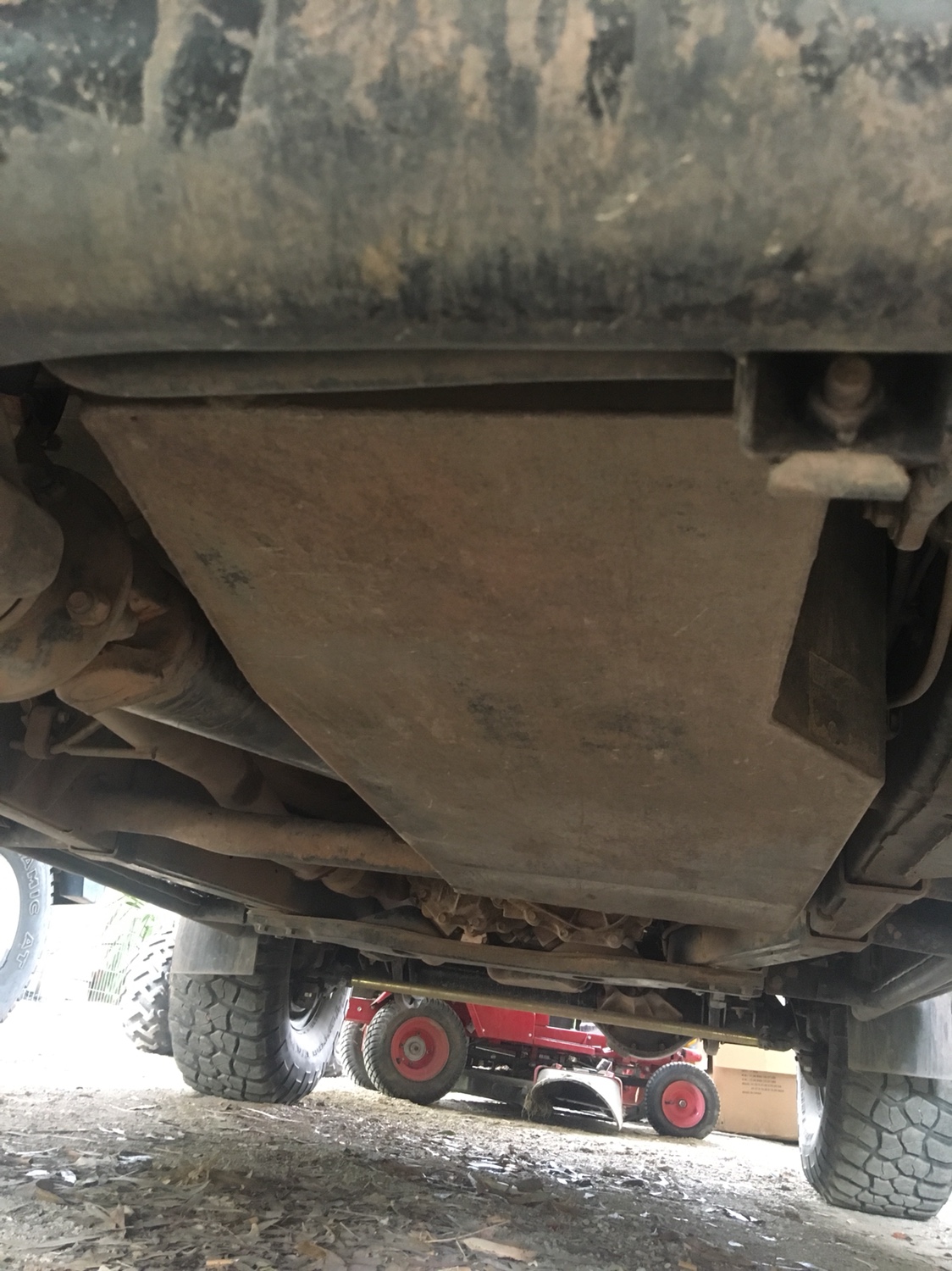

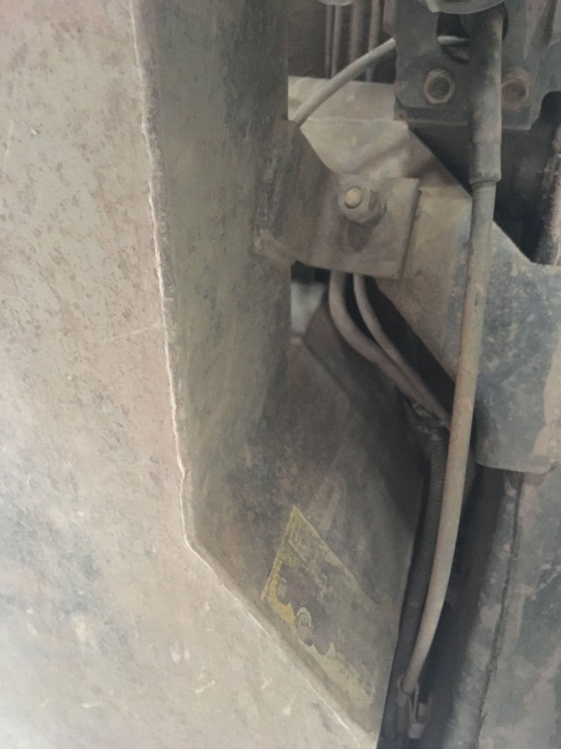

    @PeeBee pics of AB’s GQ wagon tank.
    Rear mounts x 2 onto cross member Front mount x 2 bolts onto cross member also. Where’s the beasts keys @AB ? :-)

    Thanks Mark, gives me a good start, now just have to work out how to get the tank up into position, packing boards I am thinking.

    Will do my very best mate to finally visit your Cantina before years end and help lift. After properly seeing AB’s today I’m thinking they have designed it pretty bloody well. Looks like the front can be lifted and wedged onto the cross member then thinking a little ratchet strap to lever up the back end and hold whilst marking holes then drop/drill and repeat for final bolt up maybe could work for us?
    No sweat mark, not stressed if it doesn't happen until Feb. I will focus on finishing the endless air project, then am off to Pirtek tomorrow morning for the hose to connect the aux. oil cooler. Feel free do simply drop around if you have the time anyway. Your method has me thinking now, so will have a look again in the morning.
