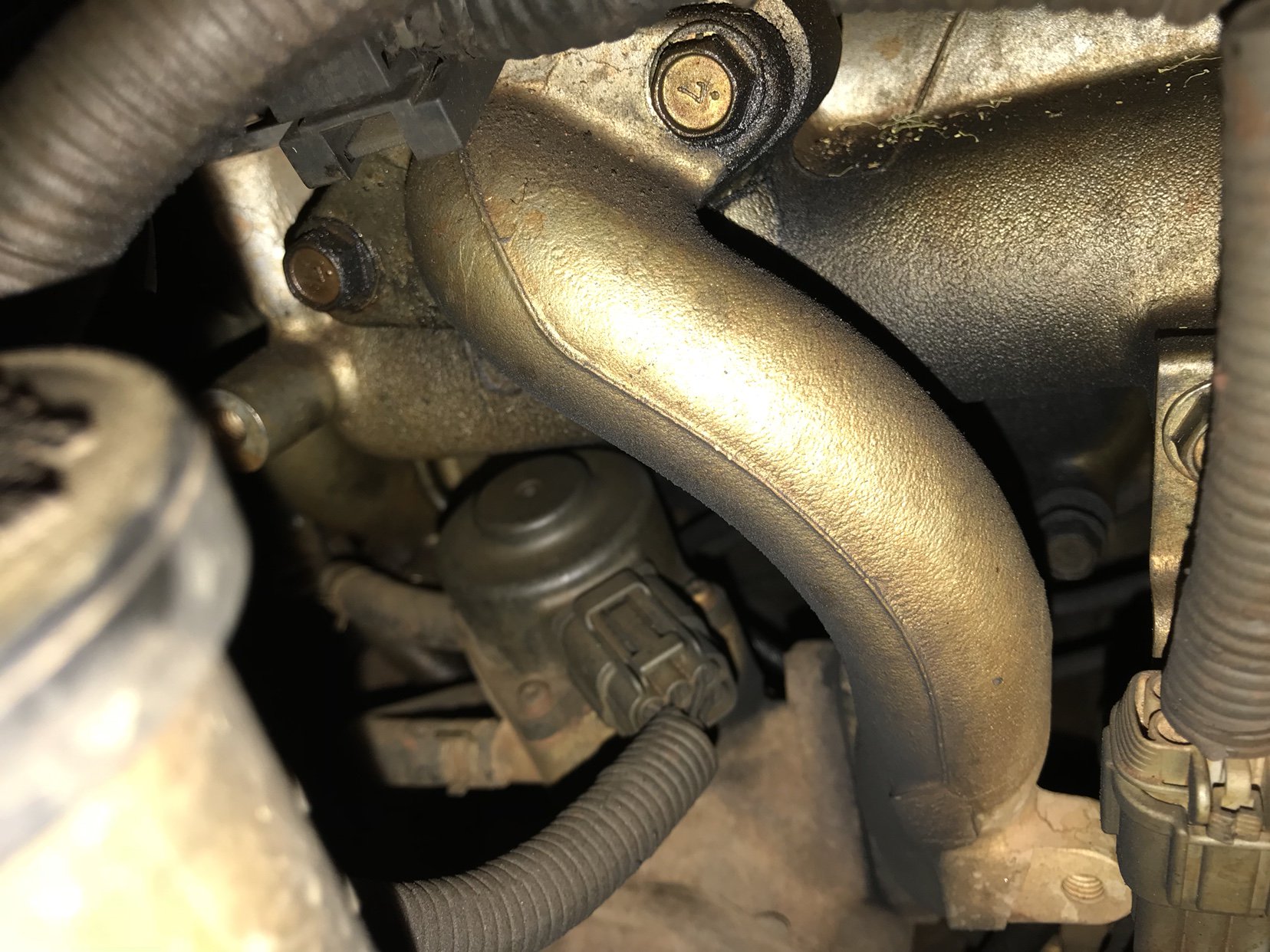

    Hey guys!
    Was doing a service on the patrol over the weekend and after pulling my fuel filter off I noticed that it was covered in soot on one side.
    Took some photos, let me know what you think. Easy fix or better to go to a mechanic?

    That to me looks like a EGR pipe that goes onto the intake ? Drivers side? EGR pipe could be leaking or cracked perhaps.
    Yeah your right, defiantly egr pipe, I shoulda picked up on that earlier.
    Hopefully just a new gasket and should be right?

    Could be a gasket but also could be a cracked EGR pipe.
    On my crd it was a cracked pipe.
  6. #5
    31,634
    Its a known fact they tend to crack the egr pipe.
    normally with a whistling sound that goes away as it warms up
    Yeah i have a whistling sounds at the moment. Will pull it out over the weekend and let y’all know!
