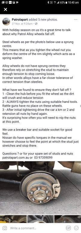

    @alloysfallingoff

    In other words do it up until you snap the stud, then back it off half a turn! I did not realise that the alloys rely on the stud so much. It makes sense to change out the studs periodically while running alloys.
    That's exactly the way I read it , another good reason to go Steel rim I reckon .

    I run the alloy rims on both my Patrol and Caravan and never had an issue. In 2013 we did about 12,000km including Cape York and 23,681,132 corrugations on the PDR.
    Patrol has now done 120,000+ kms, I always use a tension wrench and torque to 133nm as specified and I use the indicators as supplied by Nissan. Always check the torque setting on a regular basis and never need tightening.
    We've done some pretty rough and rocky tracks and touch wood no major damage to the rims, just some minor scratches.
    Maybe I shouldn't push my luck but with two sets of tyres and alloy rims I'll keep using them.
