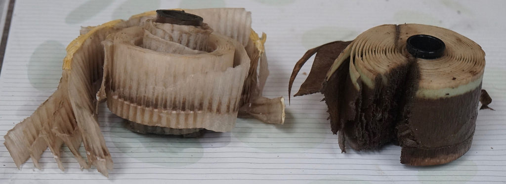

They are the Delphi version of the CAV type glass bowl filter, bought online from Ebay/Wagga Tractors. Delphi 296. Depending on where you look they are either 5, 5.5 or 6 to 9 microns!
The diesel in the glass bowl had a fair bit of fine sediment in it, whereas the diesel I drained from the standard filter was very clean.
