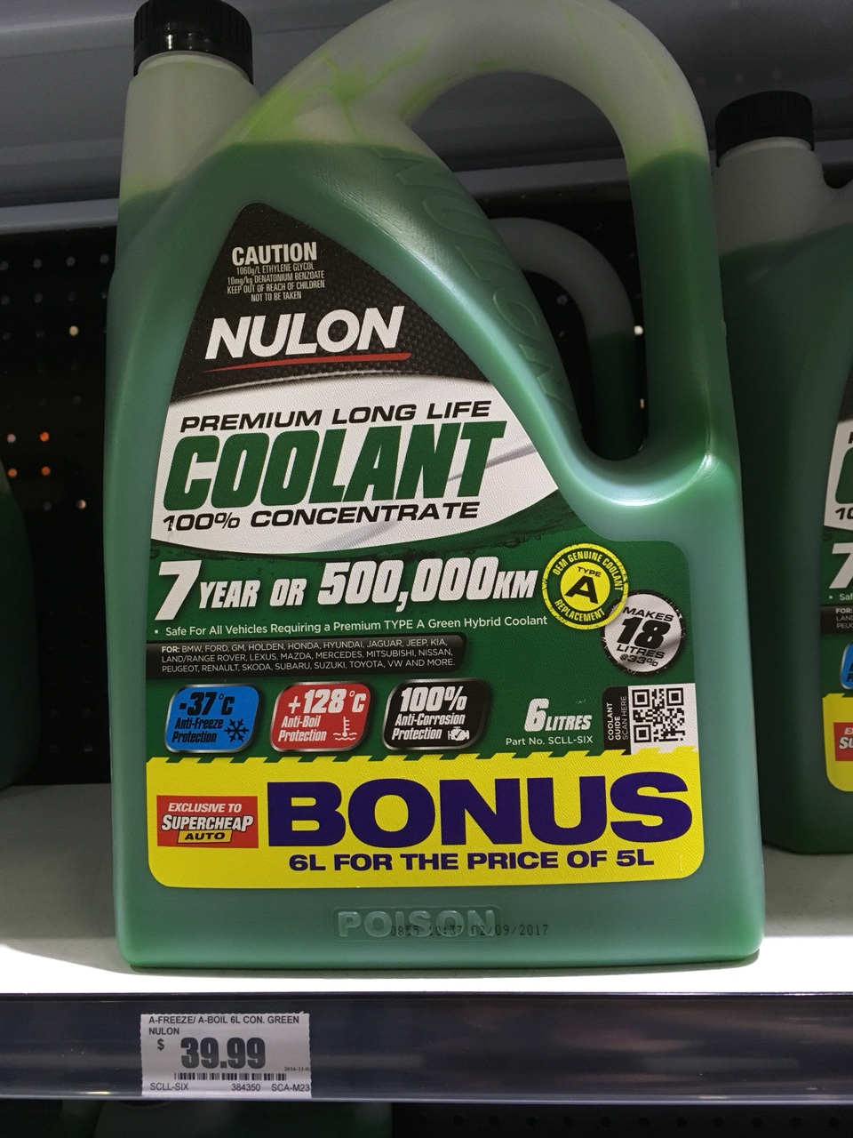

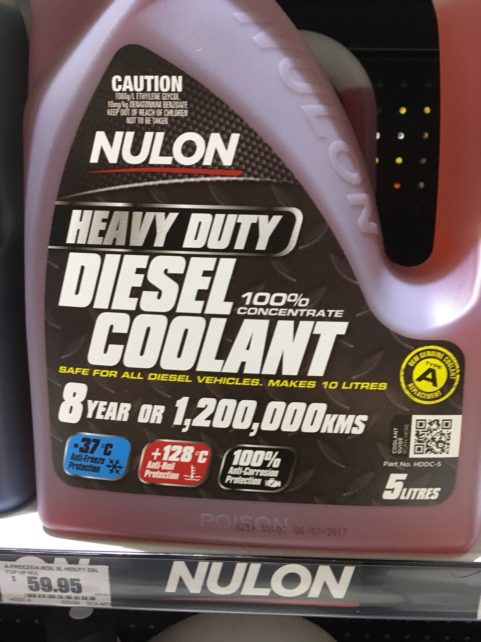

    Supercheap have nylon green ($40) and also a heavy duty red one specific for diesels ($60)

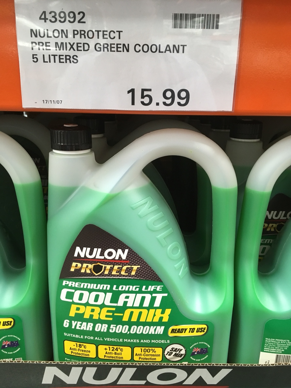

    The I found another nylon green one at Costco for $16!!
    Now the Costco one is a premix, so I’ll need to buy 2 bottles todo the same job.

    That first Nulon mate I've used on all my 4x4s. 2 Patrols and a navara and it appears it does the job just fine.

    I put the first Nulon in the Hyundai Excel.

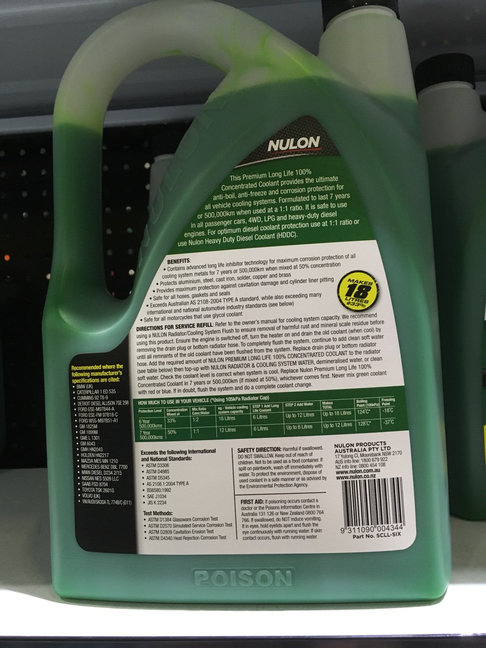

    Read the fine print, 18 litres at 33%, 12 litres at the recommended 50%.
    Concentrate is better than pre-mix because there is always some water left when you finish flushing.

    I use the first Green Nulon. I wonder what the actual difference is, apart from colour, and labeling, between the two Nulon variants.

    Was wondering the same thing. The second one says Diesel and 1,200,000 Km?!!
    I'm assuming the "diesel" bit is maybe for the trucks since they do a ton of km's? I dont know. As above, Ive been using the first one for years . No dramas.

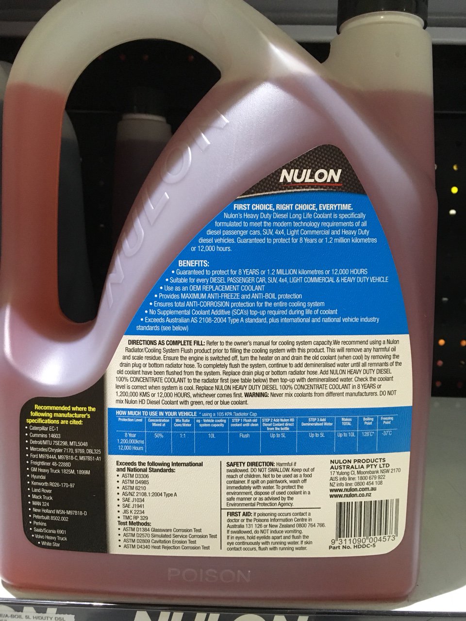

    Min and max operating temps by the look of it - its on the label!!!!

    Thanks for all the feedback guys, here’s the back labels of the two nulon ones from supercheap if it helps

    Yeah I'm just a skeptic though. I've been in this trade for over 20 years now and seen a few tricks to generate sales in my time. So I tend to question the validity of some things.

    we use the first one to,john deere tractors,change cooland as per manual,every so many hrs or years..they prob do 1.2milkm...but i bet they change the coolant more often than that lasted the whole time..
