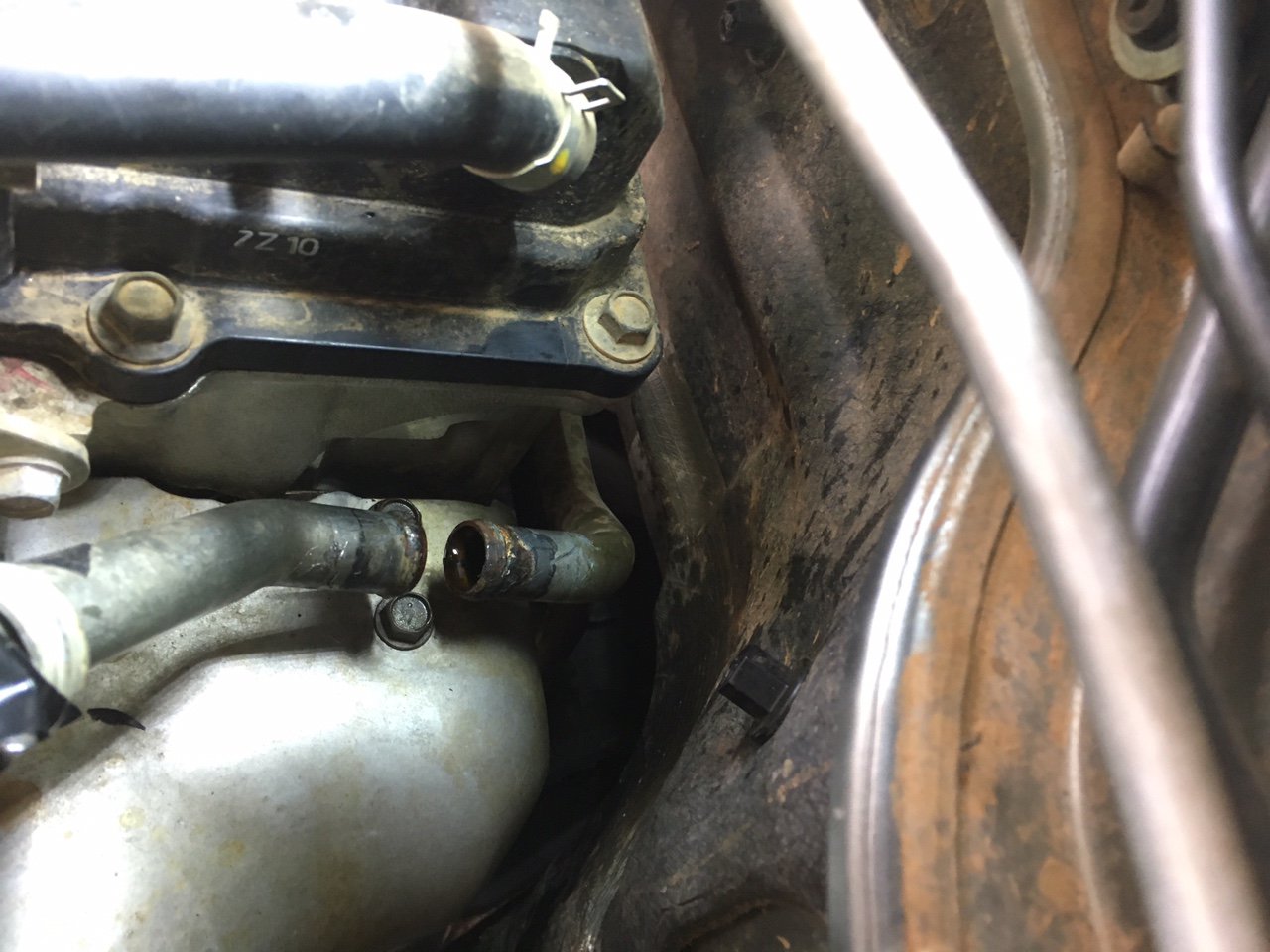

    I've left it like this for the last 2 days, absolute PITA to try and get this hose on. Tried wd40, heat, brute force etc. wife is out tonight, so once kids are in bed I'll give it another crack
    Damaged hose removed
    Progress of installing new pipe lol... it's a staged process!!
    Had to replace same hose mate my crd.
    Had a tub of really hot water next to me. New hose dipped in for 5--10 mins.
    Slipped straight on to the left pipe and then back onto the second metal pipe.

    That sure is ugly, good luck!

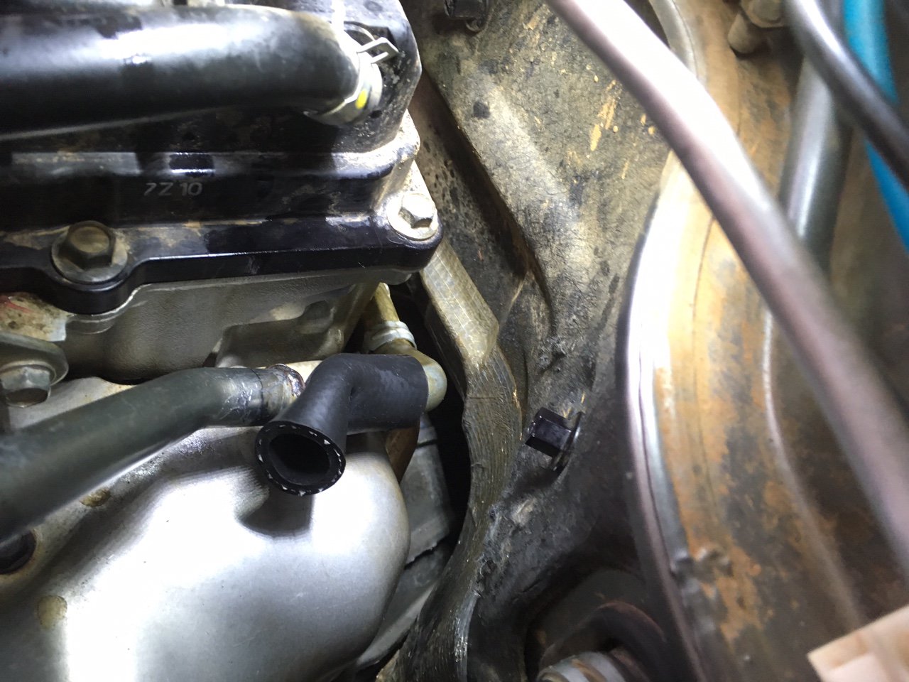

    Ah ok,
    I might try slipping it "up" the pipe on the left then! Thanks for the suggestion!
    Yeh cheers Phil lol

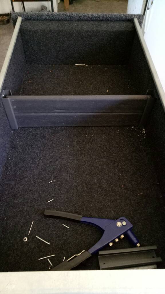

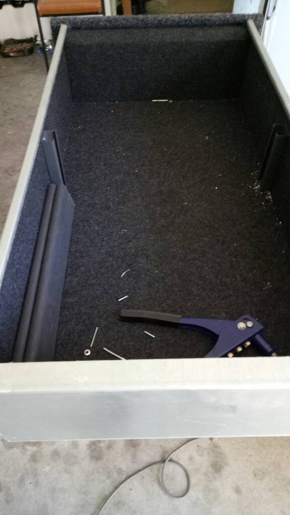

    Something that I started along time ago.
    Some removable dividers.
