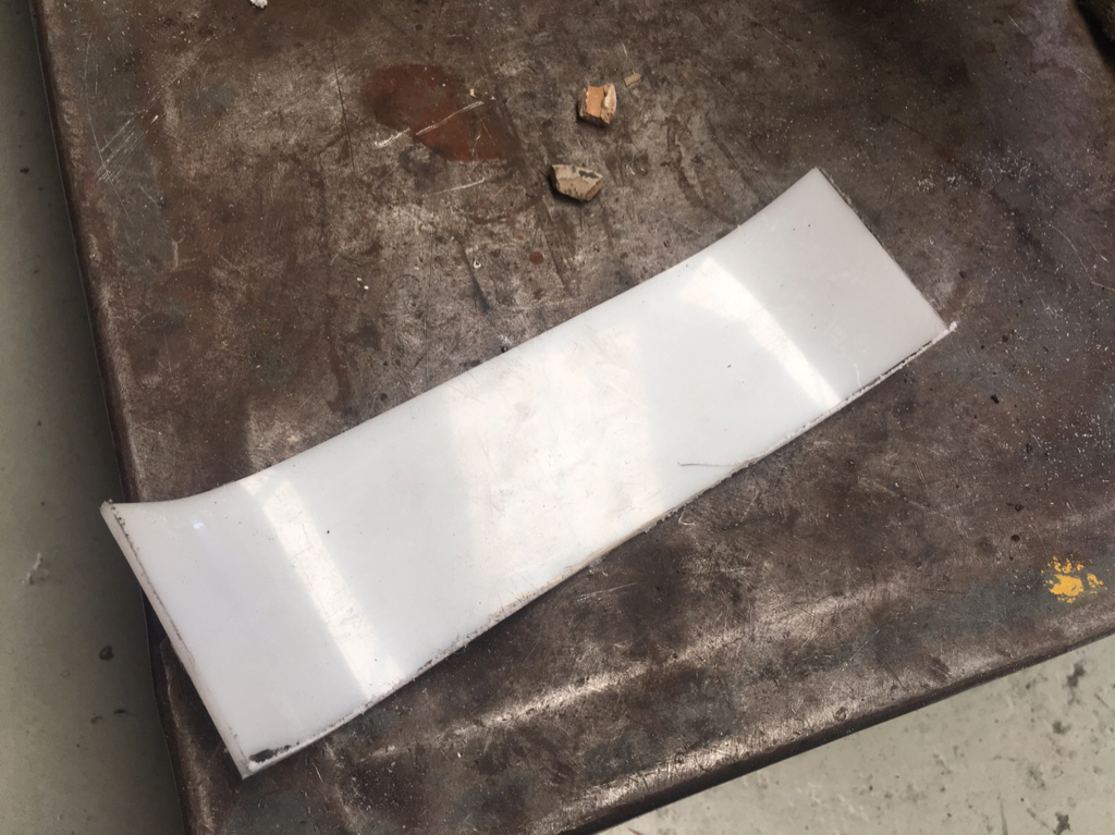

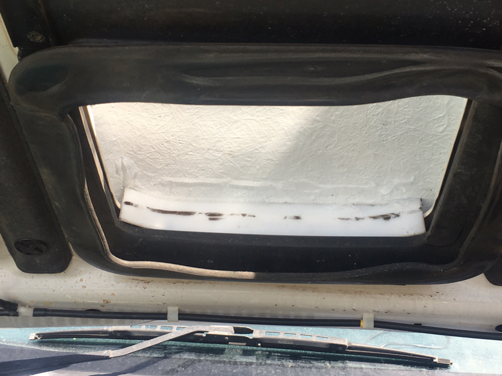

    @LaughingBeagles Hey Pete , I noticed a bit of air escaping from the scoop when I did the run to Ravensthorpe last week. Could see it with the dust and rain showing a pattern behind the scoop. Anyway I have made a deflector from a bit of plastic and sicaflexed it on. Seems to get a bit more air going down instead of getting trapped in the back of the scoop

    Great idea Tony! Don't happen to have a spare bit of plastic at yours do you?

    Umm yea I do actually. As in the first picture. Just need to cut to size.
