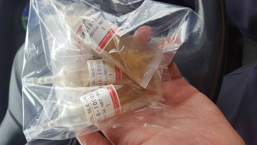

    G'day Roly, quite strange that your new clutch fan is also not engaging. Maybe return it or use the search function on here as I remember reading blokes using Toyota hub oil with great success apparently. If it were me I'd turf that radiator, hoses and thermostat for peace of mind with such a long adventure ahead of you. Not sure how to test water pumps, hopefully someone here can help you there too. Good luck mate, hope you can get back on the road soon!

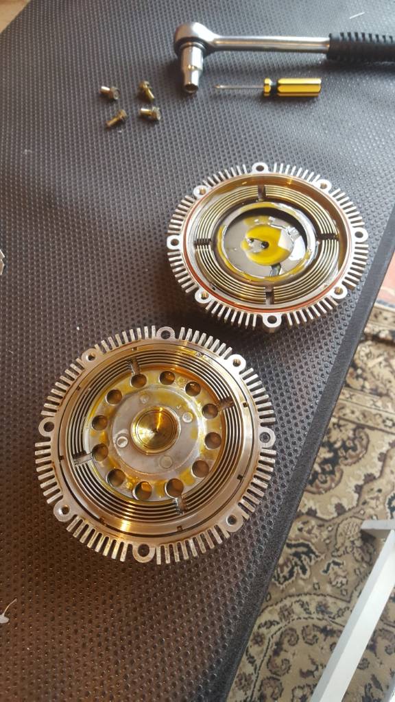

    I'm toying with the oil quantity in the viscous clutch. on my right now. Since I've put a larger fan on.
    The fan moves a lot of air when very cold. And then generally eases up ..kind of like the eye of the storm .
    And then gradually the clutch grabs firmer as the hot air from radiator heat's it up.

    Just google viscous coupling in YouTube. Some great videos explaining exactly how they work.
