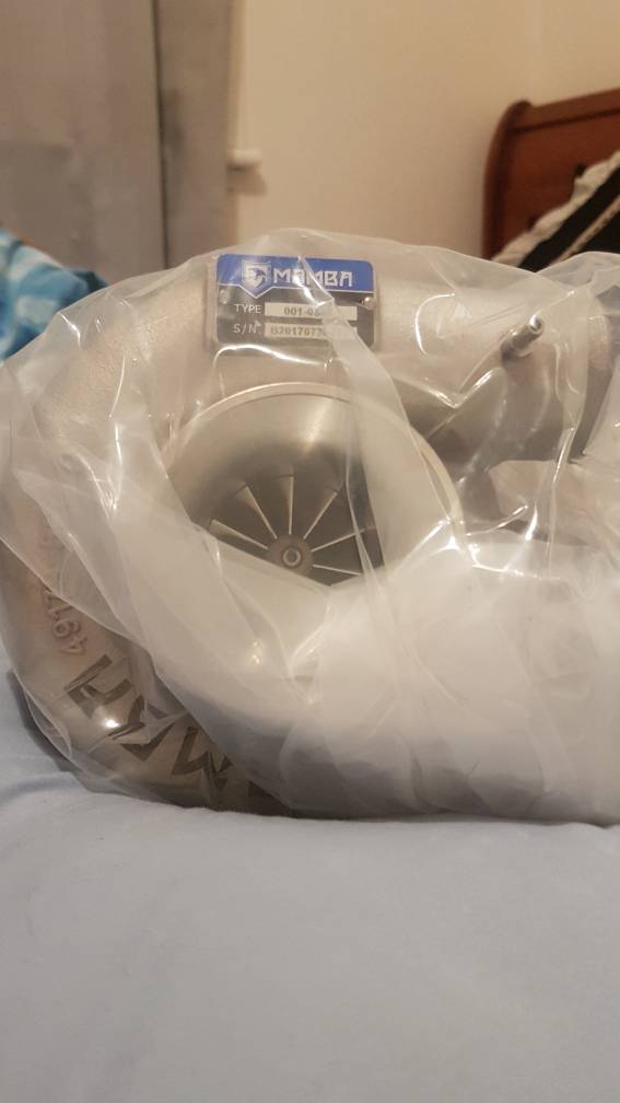

    Hey guys im about to do a turbo install 16g mamba!! Is it ok to run my oil drain on the back of the alternator? Anyone have photos of this?
