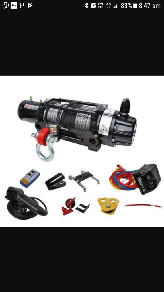

    Is your Runva winch the one like in this picture ???
    Because I'm about to do the same to mine . Except mines very stiff on freespool. But I've got warranty grounds there too so I can just send it in .
    But id like to do it my self to learn the ins and outs of it. See my thread about it here.
    http://www.nissanpatrol.com.au/forum...ad.php?t=40664
    My old TJM OX winch is stiff on free spool. Even after I serviced it. So I left it thinking thats how they are. I think I've used my winch maybe five times in five years. Everytime for bog holes. Now I just go around those.
