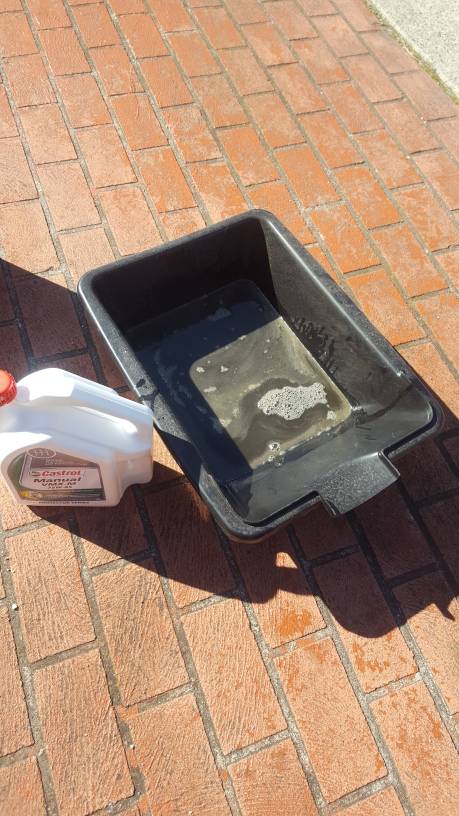

    Hey mate. Replaced my oil , or should I say , water with oil, on Saturday. Bought a 4L bottle and had 1L left over after .
    So you're not the only one.
