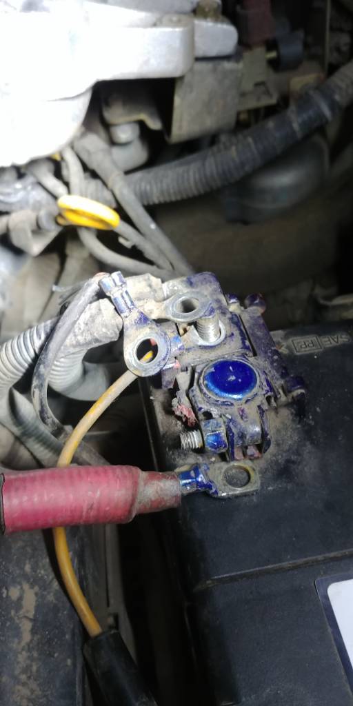

    I've attached some photos. The first 2 are my main battery and the 3rd is the terminals on my aux battery.

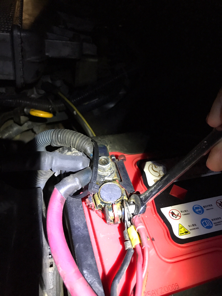

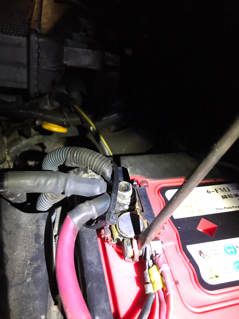

    Trying to get this positive terminal off and I have a bunch of different connections that I have no idea what they are for

    Undo the 10mm nut and the whole thing will come off
    At a guess the large lug closest goes to your second battery , 2 that are off are part of the car and the red one could be for driving lights
    That's just a guess, but put them all back on where they came from and just undo the 10mm nut and give it all a wiggle
    Make sure all those eyelet terminal are clean by giving them a quick hit with a wire brush or sand paper. Most battery problems happen from bad connections

    All of that is connected to the positive terminal on the main battery under a nut on that thread at the top. That other nut I cannot get a spanner or socket in there to get it off.

    Use a 10mm spanner to undo the nut, wedge. A screw driver into spread open the terminal and it all comes off in one piece

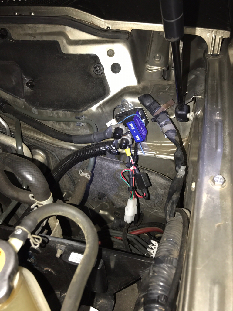

    The other pic is my solenoid and inside is a light to indicate that the solenoid is on and a switch to join both batteries if needed.

    Youre a legend, cheers. Will have another crack tomorrow. I don't have a solanoid or switch or anything though .

    If there is no 2nd battery management like smart solenoids/relays/switches etc then it is a 90 % chance that the prev owner was simply running two batteries in parallel.
    This is reasonably common in a vehicle set up simply as a tug as opposed to a vehicle with a 'camping' load such as Fridges, Lights etc.
    One way to tell is the size of the cables and how many were connected to the 2nd battery +ve.
    If there was only one 'thick' cable to the 2nd battery +ve direct from the original battery then the above is the case (I am assuming there is no winch involved)
