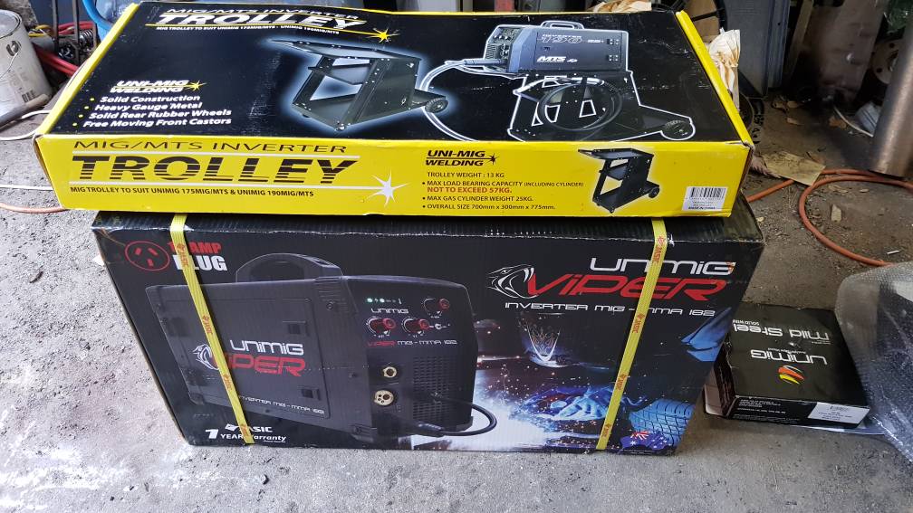

    So Dom what did you end up going?
    Ive just invested in a new unimig viper.
    It's only mig, but i have my tig in my other machine.
