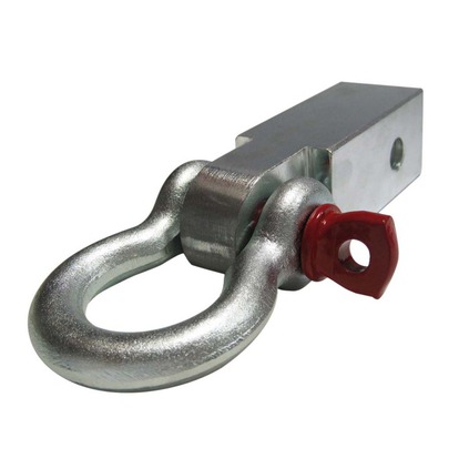

    Sorry if this is a dumb question but I am new to 4wding. So I have been using the a rear recovery point that slots into the tow bar as in the pic to get towed out backwards. what do I hook up too at the front of my car that can be used as a recovery point? seeing as I shouldn't be using the front tow point
